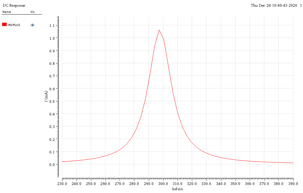

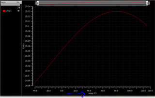

Hi ALL,
can you please suggest how can I change the scale of a temperature sweep plot from Celsius to Kelvin ? I did set the units to Kelvin in ADE-L but that didn't seem to help to change the X axis (temperature) scale.
thank you
    Setting the units on the temperature form doesn't change what you're sweeping - it merely makes it easier to set a single temperature. The units in spectre are always Celsius.
    You can easily achieve what you want in ADE L (assuming you're doing a DC sweep here) by doing:
    1. Create a variable called "kelvin" with value (say) 300
    2. Create a variable called "tempC" with value kelvin-273.152
    3. On the Setup->Temperature form, set the temperature in degrees to VAR("tempC")
    4. In the DC analysis, rather than sweeping temperature, sweep a variable and sweep kelvin from (say) 230 to 390.
    Voila! (this example is just the current through a resistor with some made up temperature coefficients just to provoke some kind of interesting simulation results):
