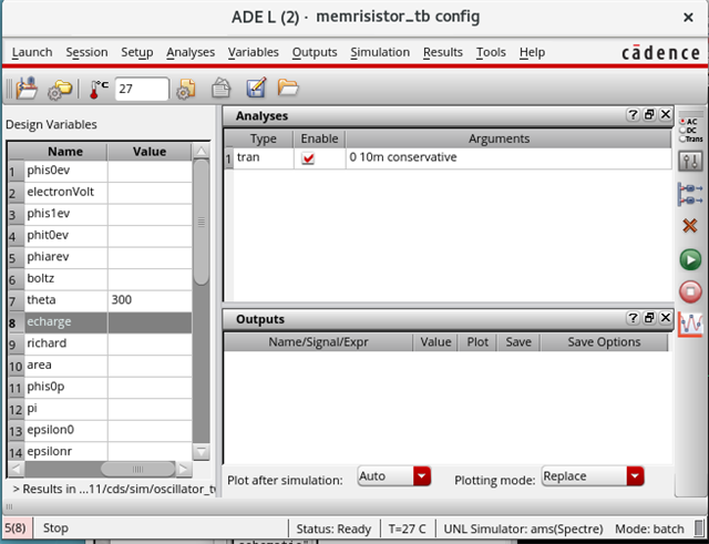

    Hello Andrew,
    thank you very much for your help.
    By following your suggestion, I have set the parseAsNumber=yes and parseAsCEL=yes in the CDF for my component.
    Now in the ADE L window all variables of my component appear in the "Design Variables" section. However, all the values of variables are empty, see attached screenshot. Can the values be automatically loaded? or shall I add those values manually, for example, I set 'theta' as 300 in this plot?
    Thanks a lot for your help ,
    Xiaocheng
    Andrew Beckett over 5 years ago in reply to xiaocheng
    If you set the variables in ADE L, and then do Variables->Copy to CellView, it will store the variable settings on the memristor_tb cell so that any time it is opened they will be set.
    It's not really clear what you want though here - I somehow doubt that these really need to be exposed variables since many of them are physical constants and cannot be changed.
    I suggest you speak with customer support so we can get a better idea of the exact form of your files and how you expect them to be used.
