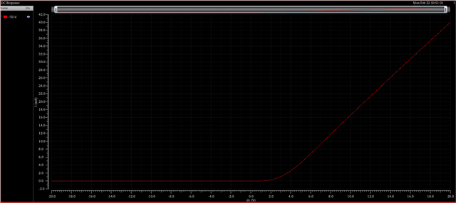

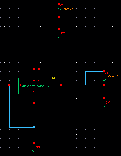

Figure 1 and Figure 2 are my circuit and Vgs-Id characteristic, respectively.
verilogtutorial_2 is BSIM-BULK mosfet, and s is source, g is gate, d is drain, and b is bulk, respectively.
Figure 1. BSIM-BULK mosfet schematic
Figure 2. Vgs-Id characteristics of Figure 1
I want to know the method that increases the current in all Vgs intervals by 1 mA.
What should I do?
Thank you

    I don't understand your question. The current is defined by the model - if you need it to be higher, you'd need to change the model (or the model parameters). I could achieve the same thing with a built-in bsimbulk example:
    // minimal model - default parameters
    model nch bsimbulk type=n
    Vgs (g 0) vsource dc=3.3
    Vds (d 0) vsource dc=3.3
    // increase w/l to increase current
    M1 (d g 0 0) nch w=2u l=1u
    dc dc dev=Vgs param=dc start=-20 stop=20 step=0.5
    save M1:d
    (this could have been done as a schematic of course - I just did it as a netlist for ease of sharing and experimentation as it's fully self-contained).
    With this example, if I increase the w/l (increase w or decrease l) the current will increase. There are of course numerous other parameters that would affect the current, but I don't know what your goal is here.

    I'm wondering if adding a current source to Figure 1 can raise the Id over the entire range of Vgs by 1 mA as I said.
    Thank you
    yysunj
    Andrew Beckett over 5 years ago in reply to yysunj
    You could certainly add a 1mA current source in parallel with the transistor (i.e. between the drain and the source) - I don't really understand why that would be useful though.
