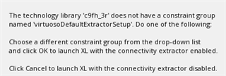

    Andrew Beckett over 5 years ago in reply to mikewu
    mikewu said:
    Could this be related? Or just a symptom that the PDK is not ready for prime time?
    I don't think the lack of a virtuosoDefaultExtractorSetup constraint group would have any effect whatsoever on ADE - ADE doesn't care about technology constraints (there are some design constraints that have an effect for optimisation and for Monte Carlo, but not technology constraints).
    It's a bit odd that there's a symbol and no schematic or stopping view. Something seems amiss, so I would contact the foundry.
