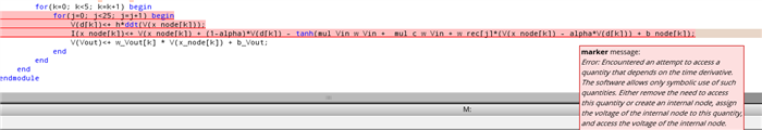

I'm new to verilogA and trying to compile a module including the following nested loop in an analog process:
for(k=0; k<5; k=k+1) begin
     for(j=0; j<25; j=j+1) begin
          I(x_node[k])<+ V(x_node[k]) + (1-alpha)* h*ddt(V(x_node[k])) - tanh(mul_Vin_w_Vin + mul_c_w_Vin + w_rec[j]*(V(x_node[k]) - alpha* h*ddt(V(x_node[k]))) + b_node[k]);
          V(Vout)<+ w_Vout[k] * V(x_node[k]) + b_Vout;
     end
end
where:
k, j are genvars.
x_node is a vector of internal nodes.
h, mul_Vin_w_Vin, mul_c_w_Vin, alpha, b_Vout are assumed to be constants.
w_rec, b_node, w_Vout are parameter vectors.
Vout is an output port.
I'm trying to force the current branched from these nodes to 0 and use the simulator to solve for V(x_node[k]).
I had this error at the bolded line:
Error: Encountered an attempt to access a quantity that depends on the time derivative. The software allows only symbolic use of such quantities. Either remove the need to access this quantity or create an internal node, assign the voltage of the internal node to this quantity, and access the voltage of the internal node.
I couldn't fully understand what's the problem with using "ddt()" in the expression, Can you please explain a bit more about the problem and the suggested solution?
Thanks in advance,
Ramy
    Andrew Beckett over 5 years ago in reply to rhanna +1
    Hi Ramy, You're missing a close parenthesis (I've added it back - and highlighted it in red below): I(x_node[k])<+ V(x_node[k]) + (1-alpha)* h*ddt(V(x_node[k])) - tanh(mul_Vin_w_Vin + mul_c_w_Vin …
    Hi Ramy, The issue is because of the assignment to the variable c earlier in the analog block - that's then used in the calculation of mul_c_w_in in step 2, and then that's used within the tanh() in…
    Ramy,
    The challenge is that the simulator needs to keep track of the history when computing a derivative, and it's hard to do that when it's embedded within an expression (in this case it's within the argument to tanh). You can workaround this by using a temporary internal node - something like:
    V(tempNode[k]) <+ alpha* h*ddt(V(x_node[k]));
    I(x_node[k])<+ V(x_node[k]) + (1-alpha)* h*ddt(V(x_node[k])) - tanh(mul_Vin_w_Vin + mul_c_w_Vin + w_rec[j]*(V(x_node[k]) - V(tempNode[k])) + b_node[k]);
    You'd declare tempNode as and internal node:
    electrical[0:5] tempNode;
    Note that you may need to scale the value appropriately to ensure that the voltage is reasonable (I don't know enough about the system or the coefficients to understand the magnitude of the result of this part of the expression). In essence you want the voltages to be similar range to those in the rest of the circuit to prevent convergence/accuracy issues (so probably up to a few volts, no more).

    rhanna over 5 years ago in reply to Andrew Beckett
    Thanks for debugging this.
    After correction, it seems to have the initial error.
    Ramy
    Which version of Spectre are you using? In the terminal window type "spectre -W" to find this out.
  • rhanna
    It's 19.1.0.496.isr12
    Ramy
    I see you made another small change from that image, but even with that, I can't reproduce it (even with the same version of Spectre). Perhaps I couldn't spot a small difference somewhere.
    It's probably easier if you post the entire code - at the moment I'm making stuff up around the bit you've shown here, and maybe the problem is dependent upon the context it's in? Hard to be sure (since I can't reproduce it).
