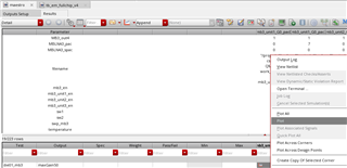

Hello everybody,
I recently discovered through another post here on the forum the VIVA function (see below) to include bookmarks on the charts. This one below create a red area from 2.11 GHz up to 2.66 GHz. This is a good way to highlight a specific area when plotting data.
awvPlaceBookmark( currentWindow() "xrange" list(2110e6 2200e6) ?waveIndex 1 ?description "B66" ?properties list(list("fillColor" "red") list("defaultLabel" "defaultBookMark")))
Currently I define this function (and others for other freq. ranges) in a text file which then gets uploaded into the expression editor thru the calculator
The function works well as long as I plot data directly from the Maetro--> results (see below)
However, if I copy that trace into a new window and I try to plot the bookmark again, I get the following error message in the CIW:
ERROR (WIA-1005): Waveform with the ID 1 does not exist.
ERROR (WIA-1015): Cannot place bookmark because waveform '1' is not visible.
ERROR (VIVA-3002):expression evaluation failed: Expression evaluates to nil
I tried to replace the function "currentWindow()" with others, but it doesn't help. Is there a way to plot this bookmarks on any desired selected chart ?
Is there also a way to store them in the Output Setup instead of the text file ? (it would be more handy)
Thanks
Tommaso
    Hi Tommaso, The issue is that the waveform index number in the copy is no longer 1, and so it can't find the waveform. To make it easier, I've just written a wrapper function which allows you to specify…
    Hi Tommaso,
    The issue is that the waveform index number in the copy is no longer 1, and so it can't find the waveform. To make it easier, I've just written a wrapper function which allows you to specify the waveform to add the bookmark to by name rather than by index. So you'd change your call to abPlaceBookmarkByName and change the ?waveIndex 1 to ?waveName "/out" (or whatever the signal is called in the plot).

    Andrew Beckett over 5 years ago in reply to TommasoF
    Hi Tommaso,
    Actually, if you create the bookmarks using SKILL, and then save a plotting template from ViVA into the maestro view (which is a new feature in IC6.1.8/ICADVM18.1) then you can plot the graphs again with the same bookmarks as before - this is the preferred way of restoring markers and bookmarks to the graph, and having the same graph arrangement as before.
    However, there isn't currently a UI way of adding bookmarks on the graph, which would be needed for this to be really useful and accessible. I believe (from when I've looked at this in the past) that there are requests for this, but the focus with bookmarks was having sufficient support for them to be used programmatically as that was mainly what they were used for (for example, with checks-and-asserts, it can show the region of a waveform with an assertion failure).
    You might want to contact customer support to ask for a menu in VIVA to add bookmarks. You might want to mention to the AE CCR 1583128 which talks about some of the incomplete parts of the bookmark implementation right now.
