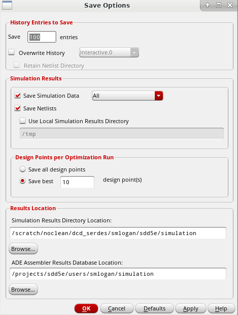

    If your steps  3, 4, and 5 were all done in Linux (and not Assembler), this will impact the database directory as it may not be current. As shown in Figure 1, in the Save Options panel, there are two directories listed - one for the simulation results and a second for the "Ade Assembler Results Database Location". If you navigate, in Liunx, to this directory and locate the test bench you are simulating with Assembler and follow its subdirectories :.../maestro/results/maestro", you will see a".log" file and an ".rdb" file for each for your runs. When you did a Linux move operation and then replaced it, this may have impact the directory id in Linux - and I am not sure to what extent Assembler uses the id of a directory in its database...this is beyond my knowledge base! However, I suspect that you did something to the "Interactive.0" that precludes the Assembler database from recognizing it. Using ocean to traverse the database will work whether you move "Interactive.0" or not. hence, if you know how to write an ocean scrip to access your data, you can put the Interative.0 directory anywhere you want. Of course, you can also open it with Results browser.

    Figure 1

    This is a topic that would probably take too long (certainly longer than I can really give this week at least) to describe the complexity of where data goes and where it is referenced. It's more suited to something that should be asked of customer support.
    The "right" way of doing this is to go over the history name in the Data View assistant, and do right mouse->Save Results. That should update the references in the database to where the data has been saved to.

    Results browser is always an option, but losing the link to Maestro means my equations are not useful anymore.
    Right mouse -> Save Results over the history name works great!
