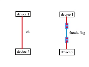

I have some devices that should be connected through a single metal connection:
Is there any easy way to detect that situation (right) using DIVA?
    My guess is that probably using the drcAntenna command in Diva would be the way to check this. That said, I'm rather rusty with Diva (despite many years of supporting it, I've not done my with Diva for a long time) and this is a slightly unusual requirement. It seems to be it is close to an antenna-type check requirement.
    Perhaps worth reading that part of the Diva Reference manual?
