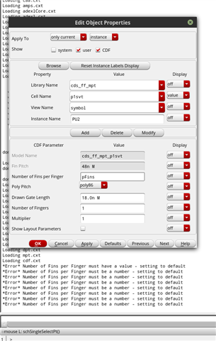

Problem: I wanted to see the variation in the inverter characteristics by varying the number of fins which requires making fins a parameter (ie ., a variable pFins for example). But if I give anything other than the number I will be prompted with an error message on CIW as shown below
*Error* Number of Fins per Finger must be a number - setting to default
PDK used: cds_ff_mpt
Schematic editor: ICADVM181
Is this a bug?
Any workaround is there for it?
Can you please provide a solution to this?
    This is a limitation of the PDK - not a bug as such, but a conscious choice to disallow variables. Sometimes this is an oversight but sometimes it's to ensure derived parameters can be computed.
    That said, if you use ADE Explorer/Assembler then you can use the Parameters section to specify an override and sweep the parameters that way without needing to put a variable on it.
