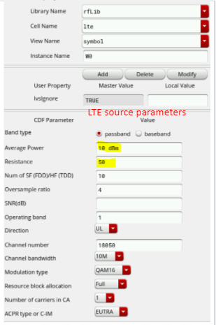

    For the LTE signal source which parameter can I use to generate a LTE waveform at 2Ghz ? As of now my CDF form for this source looks like the following -

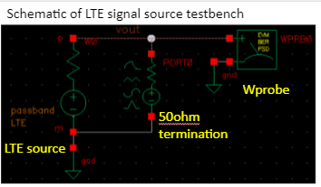

    Below is the snapshot of the schematic testbench with the LTE source -

    Andrew Beckett over 4 years ago in reply to sidm
    It's a bit tricky to get exactly 2GHz (I didn't try to figure it out entirely because there's a limit to how much of the ETSI standard I wanted to read for fun - https://www.etsi.org/deliver/etsi_ts/136100_136199/136101/15.03.00_60/ts_136101v150300p.pdf ). Anyway, if you pick Operating Band 23  and Channel Number 25550 then you get 2.005GHz (with a 10M channel bandwidth). There may be other ways of getting the frequency you want - but the source is controlled by the operating band and channel numbers in the standard.

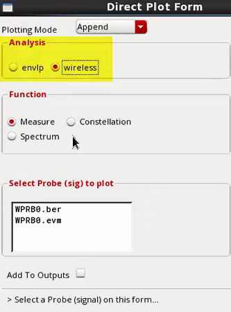

    sidm over 4 years ago in reply to Andrew Beckett
     Thank you very much Andrew for the details. In my case I don’t see the CCDF option , not sure what can be the reason for that ?
    Snapshot below for reference – (in the Wireless RAK the CCDF option is shown where the cursor is in the below snapshot)
