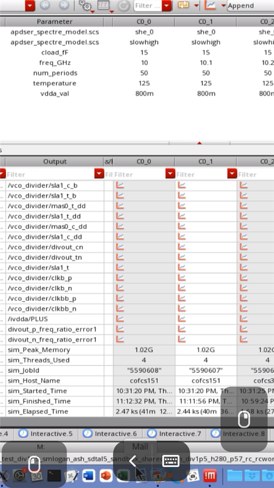

    Dear Andrew and JacobG,
    You best me to a response Andrew -which is nothing new of course for you!!
    However, I will add that I use this feature in all my Explorer and Assembler runs. I've added the following lines to my .cdsint file:
    envSetVal("maestro.results" "enableRunStatisticInfoDisplay" 'boolean t)
    ; You can customize which items you would like to be displayed using
    ; the “defaultRunStatisticItems” environment variable like following:
    envSetVal("maestro.results" "defaultRunStatisticItems" 'string "memory,threads,jobId,host,startTime,endTime,elapsedTime")
    and an example of the resulting run statistics it produces in a set of Assembler simulations is shown in Figure 1.
    Shawn

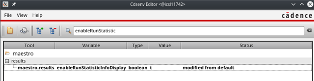

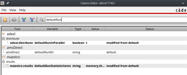

    Andrew Beckett over 4 years ago in reply to JeyJey
    First of all, you need to also have:
    in the file. If that doesn't work, then it's probably because this "vmac" command that you're using is not passing through the -restore to Virtuoso. Again, that's for your local CAD to deal with because vmac is not from us...
    As a workaround, you can go to Options->cdsenv editor in the CIW, search for enableRunStatistic and then turn on that option.
    I'm also assuming you're using an IC version later than IC6.1.8.500.14 (or ICADVM20.1.500.14) because that's when it was introduced.

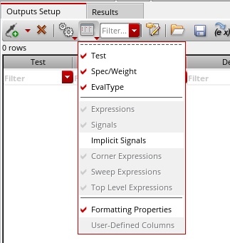

  • JeyJey
    JeyJey over 4 years ago in reply to Andrew Beckett
    I see enableRunStatistic and defaultRunStatisticItems  in the cdsenv editor, it is looks turned on.
    No this option here and it doesn't appear after I run a test.

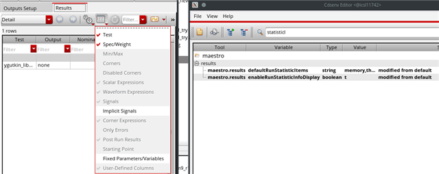

    They should appear on the Results tab, not the Output setup tab. So your screenshot above is not very instructive.
  • JeyJey
    It is the same there
