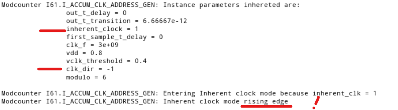

I am trying to build a VerilogA model for a (lookup_table) with instance name "I_ACCUM_CLK_GEN_LUT" that is addressed by a modulo (mod_counter) with instance name "I_ACCUM_CLK_ADDRESS_GEN". The read value from this lookup table is then used as clock to another instance of the (mod_counter) called "I_LATCH_CLK_GEN".
All three instances are instantiated in a parent module (mth_residue_estimator) attached

The mod_counter child module is capable of being triggered by the positive/negative or both edges of an inherent clock (just timers) or an external clock provided via the "clk" input. This is controlled by the "clk_dir" and "inherent_clk" parameters respectively. A generate construct is used.
A $display is used inside each condition to see its inherited parameter values and how the generated behavior will be. All this is shown in the attached code.

Case 1 (netlist attached below):
When any number of (mod_counter) modules are tested alone at the top level to see if the module acts as expected, it indeed works correctly for all combinations of "inherent_clk" and "clk_dir". This can be guaranteed by the outputs of the $display in the output log shown below
Case2 (netlist attached below):
However, when 2 (mod_counters) are instantiated inside the (mth_residue_estimator) as shown above and an instance of (mth_residue_estimator) is tested, I got a weird behavior.
Both counters inside work as if they are in the inherent_clock rising edge mode, i.e., as if "inherent_clock" = 1 and "clk_dir" = 1 which are the default values of those parameters inside (mod_counter) module, although the values for these parameters are different for both instances during instantiation and the $display statements say that the inherited values are correct.
Basically what is happening is that both instances of (mod_counter) take the parameter values correctly from the parent instantiator module (mth_residue_estimator) and then ignore them totally and use the default values to use in the conditional generate blocks for some unknown reason.
Case 3 (netlist attached below):
This also happens to any module of (mod_counter) instantiated outside (mth_residue_estimator) but in its presence in the netlist. Here I used the same instances instantiated in Case 1 above with their parameters unchanged.
Although they worked correctly before when (mth_residue_estimator) wasn't there in the netlist. I5, I4 and I1 are now behaving incorrectly in the presence of I61.

I hope someone could help.
Best,
Ahmed

    Andrew Beckett over 4 years ago in reply to AAbdelRahman
    Ahmed,
    This is a bug related to handling of generate statements when there are hierarchical instances within VerilogA. I've reproduced your issue.
    I'll file a change request for this later today as I spent the time reproducing it. I know that contacting customer support is tricky for you (from your other post).
    Andrew Beckett over 4 years ago in reply to Andrew Beckett
    Ahmed,
    The change request is CCR 2590873.
    Hi Ahmed,
    R&D found the bug and have fixed it. The plan is for it to be in SPECTRE20.1 ISR15, which should be available around the end of February (I don't have a date yet, so this is just extrapolation). The issue was caused by using named (explicit) connections in the hierarchical instances within mth_residue_estimator. If instead you use positional (implicit) connections then the problem goes away - i.e. changing to:
    Fullscreen mth_residue_estimator_veriloga_order.txt Download

    So hopefully that can be used as a workaround in the meantime until the fix is available.
