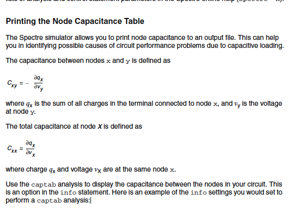

In Spectre User Manual the fixed/variable cap reported with the captab analysis is defined as follows,
1. fixed - stands for the device/wire parasitic capacitance
2. variable - stands for coupling and voltage-dependent capacitance
My question is,
1. What is "coupling" referring to? Is wire-wire parasitic, "coupling" capacitance?
2. I assume the variable cap reports the maximum capacitance. How does spectre know the operating range for this information? Is it assumed to be the max allowed range based on the process?
Thanks much!

    Dear greywanderer,
    I believe the "coupling" connotation refers to the fact that there is potential capacitance between wires and devices as well as to circuit ground. An example that suggests that connotation to me is in the Troubleshooting article at URL:
    support.cadence.com/.../ArticleAttachmentPortal
    I don't get the impression it is the "maximum capacitance" greywanderer.  I think the definition provided in the spectre user manual and shown as Figurre 1 makes it clear that the capacitances reported are based on the specific environment of the capacitance and is not a "defined maximum" or at some "maximum range". Do you agree based on the definition?

    Dear greywanderer,
    Let me provide a comment or two to my interpretation of your additional questions....other experts in the Forum may have more insight than I (well,..., definitely have!!).
    greywanderer said:
    It seems that article is refering to "node" vs "node-node" capacitance. So, "coupling" is just non-linear "node-node" cap? Is "Cgd" of a transistor a "coupling" "variable" cap?
    and
    greywanderer said:
    For Cxy/Cxx how does the simulation differentiate between a fixed cap and a variable cap?
    I think, perhaps, there may be a basic misunderstanding of what captab is providing. I will also admit that the misunderstanding may, perhaps be on my end!.
    In my understanding, the capacitances spectre reports in captab are derived from the derivatives shown above. Recall that charge is conserved by the simulator, and hence an accurate assessment of the variation in charge at a node to ground or between nodes may be made to estimate node to ground or intranodal capacitance. Hence, it is not necessary to have any knowledge concerning the nature of the capacitances at a given node or between nodes as the computations used to generate captab values do not depend on them. The capacitances may be parasitic capacitances associated with one or more traces (i.e., independent of voltage) or device related capacitances (voltage variable), but that will not impact the computation at all. In fact, i don't believe there can be a unique mapping between the capacitances reported by captab and the type of capacitor (i.e., voltage dependent or voltage independent). Any capacitor only serves as a conduit for charge to be injected or removed from a node.
    As a simple example, I've put together a couple of pages that details the computation of the capacitance spectre will report for a parallel combination of a fixed and variable capacitor with the hope that might better illustrate what I am attempting to write greywanderer. I hope this is somewhat useful or, at least, provides you with some insight.
    Shawn

    Andrew Beckett over 4 years ago in reply to greywanderer
    Well, the simulator knows whether a capacitance is fixed or voltage dependent, because it has to compute it. This is also covered in the simulator documentation - if you run <SPECTREinstDir>/bin/cdnshelp and search for captab, there's a section Printing the Node Capacitance Table which explains what it outputs.

    Andrew beat me to respond, but that is not unusual!!
    Intuitively, if a small change in node voltage changes the value of the capacitance, then it clearly is not a fixed capacitor. Since spectre has to   compute dq/dv, it will know if a given capacitor between two points has a voltage sensitivity and, if so, will be classified as "variable".
    greywanderer said:
    I presume that "captab" is a small signal analysis, so the circuit is "linearized" around the operating point
    I'm not sure why you think it's a small-signal analysis. It isn't (as far as I know). The simulator uses capacitances both in small-signal analyses (such as ac) and also in large-signal analysis (such as transient), and those capacitances arise from either fixed capacitances or variable capacitances dependent upon the operating point at the time (either DC or the current point in a transient). Since the simulator knows from the device models whether the capacitances are fixed or variable (it's having to compute them after all), it's perfectly capable of outputting a sum of each type of capacitance; it would have been using the same information in the small-signal or large-signal analysis at each timestep anyway.
