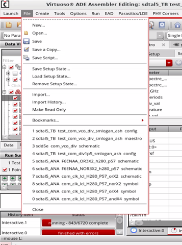

    In any case, I used ADE-XL for years and never experienced the error you suggest. Are you sure the view is just locked? What exactly is the error message? Our Cadence platforms no longer support ADE-XL and hence I cannot recreate your situation. However, as shown in Figure 1, Assembler does have a "Close" menu item.

    Figure 1
