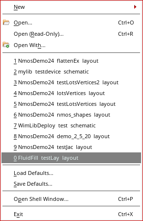

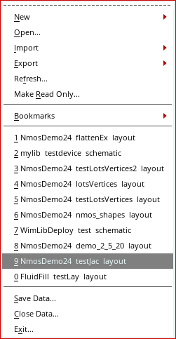

    What do you mean by "Recent Files"? The CIW and Library manager both already show the 10 most-recent cellViews that were opened - which can be increased above 10 as outlined in this post.
    This is the CIW file menu:
    and the library manager file menu:

    Thanks, sorry, I was confused because I was opening the file toolbar from Library Manager and I was getting just this.
