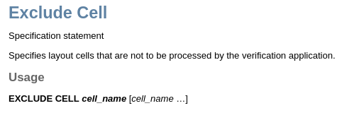

    Hello Andrew,
    Your solution works for PVS! Thank you!
    Do you happen to know the equivalent command for Calibre?
    I tried "EXCLUDE CELL" command but it does not work.
    I am aware I should have asked it in Calibre forum and I did.
    But either I post in a wrong thread or the forum is not as active as this forum.
    This is from Calibre manual.
