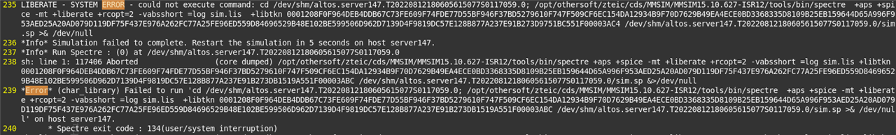

liberate version:LIBERATE 17.13.076
spectre tool:IC61/616ISR6: mmsim15.10.627-ISR12
when use liberate to rek T22nm IO cells, spectre simulation will report error likes  blews:
LIBERATE - SYSTEM ERROR - could not execute command:  cd  /dev/shm/altos.server147.T20220812180605615077S0117059.0;  /opt/othersoft/2teic/cds/M1SIM/MSIM15. 10.627-ISR12/tools/bin/spectre +aps +spice -mt +liberate +rcopt=2 -vabsshort =log sim. lis +libtkn  0001208FOF964DEB4DDB67C73FE609F74FDE77D55BF946F37BD5279610F747F509CF6EC154DA12934B9F70D7629B49EA4ECEOBD3368335D8109B25EB159644D65A996F9 53AED25A20AD079D119DF75F437E976A262FC77A25FE96ED559D84696529B48E102BE599506D962D7139D4F9819DC57E128B877A237E91B273D9751BC551F00003AC4 /dev/shm/altos.Server147.T20220812180605615077S0117059.0/sim.sp >& /dev/null
*Info* Simulation failed to complete. Restart the simulation in 5 seconds on host server147.
*Info* Run Spectre : (0) at /dev/shm/altos. server147.T2022081218060561507750117059.0
sh: Line 1: 117406 Aborted     (core dumped)  /opt/othersoft/zteic/cds/ SIM/MMSIM15.10.627-ISR12/tools/bin/spectre +aps +spice -mt +liberate +rcopt=2 -vabsshort =log sim. lis +libtkn 0001208F0F964DEB4DDB67C73FE609F74FDE77D55BF946F37BD5279610F747F509CF6EC154DA12934B9F70D7629B49EA4ECE0BD3368335D8109B25EB159644D65A996F953AED25A20AD079D119DF75F437E976A262FC77A25FE96ED559D8469652 9B48E102BE599506D962D7139D4F98190C57E128B877A237E91B273DB1519A551F00003ABC   /dev/shm/altos. server147.T20220812180685615077S0117059.0/sim.sp & > /dev/null
Error* (char_library) Failed to run 'cd /dev/shm/altos.server147.T20220812180605615077S0117059.0; /opt/othersoft/zteic/cds/MMSIM/MMSIM15.10.627-ISR12/tools/bin/spectre +aps +spice -mt +liberat e +rcopt=2 -vabsshort =log sim. Lis +libtkn 0001208F0F964DEB4DDB67C73FE609F74FDE77D55BF946F37BD5279610F747F509CF6EC154DA12934B9F70D7629B49EA4ECE0BD3368335D8109B25EB159644D65A996F953AED25A20AD079 D1190F75F437E976A262FC77A25FE96ED559084696529B48E102BE599506D9620713904F98190C57E128B877A237E91B2730B1519A551F00003ABC  /dev/shm/al toS.Server147.T2022081218060561507750117059.0/sim.sp > /dev/null's on host server147.
* Spectre exit code : 134(user/syetem interruption)
Then, I use the cormmand : spectre +aps +spice sim.sp, to run simulation with the  generated  sim.sp file . It would generated a internal error like below. I want to konw  what  should I do to solve the  problem about the REK simulation can not run.  Look  forward to your reply. THANKS.

Internal error found in spectre during initial setup. Encountered a critical error during simulation. Submit a Service Request via Cadence Online Support, including the netlist, the Spectre log file, the behavioral model files, and any other informa tion that can help identify the problem.
   FATAL (SPECTRE-18): Segmentation fault.
    Most likely you're just using too old versions of the software. The bsim6 is a relatively recent model, and you're using a simulator from 2015, and an old version of Liberate. You should use IC6.1.8/SPECTRE21.1/LIBERATE217 (I think - certainly a Liberate version from this year would make sense rather than one from 5 years ago).
