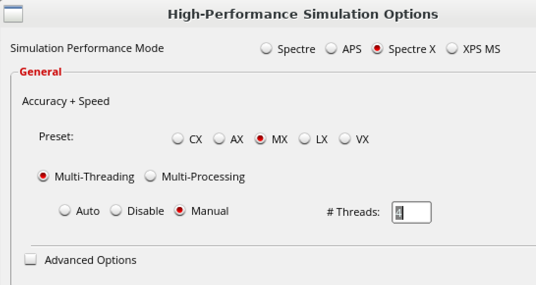

Hello, I am performing AMS transient simulations which have multiple configurations (switching between multiple amplifier gain states) to be run and each configuration is taking more than an hour to simulate so are there any possible workaround setting to Increasing simulation speed with some compromise in results ?
Have tried using 4 core option in LSF mode and even with SpectreX.
Any other alternatives to reduce the simulation time will also be great.

    SpectreX is the way to gain performance. I don't know what you tried yet but maybe you can get a bit more out of it:
    Article (20501909) Title: Getting the Most Out of Spectre X
    URL: https://support.cadence.com/apex/ArticleAttachmentPortal?id=a1O3w000009fqOUEAY
    To speed your simulation up it would be good to analyze where the simulator is spending most of the time at the moment.
    Trouble with convergence?  Having sensible rise/fall times in your switches? Check the simulator log and see at what timepoints the simulator struggles
    and then try to "help" the circuit at these points.

    Thanks for the reply ,
    my settings look like the following as of now -
    HPS settings –
    I am using Assembler for simulations.

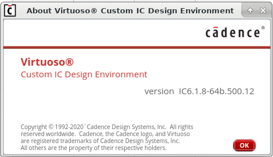

    Virtuoso version –
