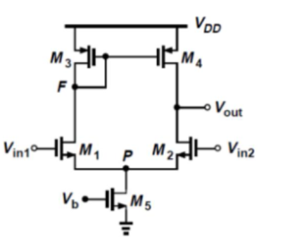

I have a question regarding ADE Assembler Parasitics/LDE Setup. Say, I have a differential amplifier as shown and I am interested to know each net (out of 8) cap to ground due to layout (assuming I have only done C-extraction) while I am on schematic view and put my cursor on that net.
I have read multiple ways to use Parasitics/LDE Setup, but neither was helpful, please comment if that is something that we can do.

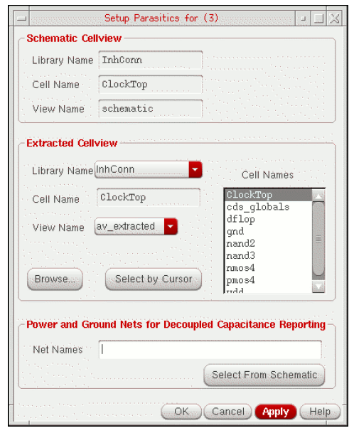

    From the Virtuoso schematic window of your differential amplifier, access the menu item Launch->Plugins->Parasitics. This will add a Parasitics menu item to your Virtuoso window.
     From the new Parasiics Menu, choose the Setup item and it will display the following GUI:
    Choose your C-only extracted view name, and after completing the rest of the from, then choose the menu item to "Show Parasitics". Alternately, "Report Parasitics" will allow you to save the data to a file. This documentation is from the Cadence On-line support site at URL:
    support.cadence.com/.../techpubDocViewerPage
    I hope this helps.

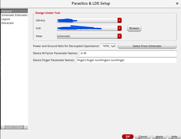

    I have a slightly different form, in ADE Assembler, I select the following
    then this is the form I have,
    Say, I have my OpAmp in library tb, with the schematic cell named tb_OA, I have created a config for this view. My OpAmp is in library named Design and has schematic and C-Extracted view (w/Calibre).
    With this info, can you comment on how to proceed?
