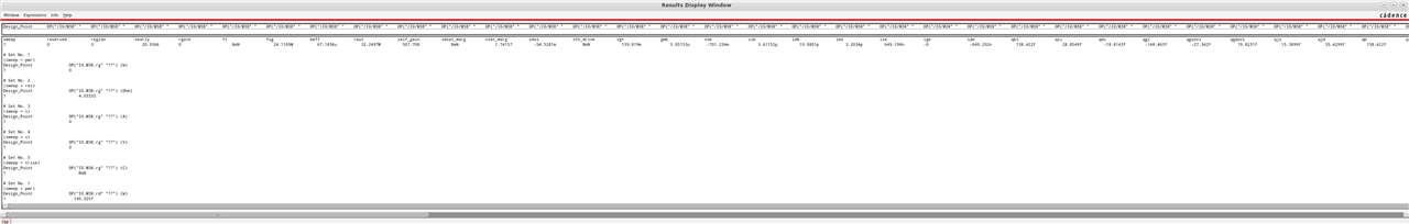

I have a design of a two-stage comparator using PMOS input pair followed by a NMOS CS amplifier. I am trying to analyze the "gm", "gds" and other relevant parameters at VDD/2 input. I am however, not able to see all the parameters that I want. I see all parameters for a few MOSFETs but I see only 7 parameters for others. In the attached image you can see that for MOSFET M50 , I can see only 7 parameters however for M38 I can see all of them. I am not sure why is this so. I mean all the parameters should be visible right?
    I apologize, but I am confused by your question and am not sure how to provide a concrete answer. I only see 6 parameters for M50 in the screenshot you included and it is not clear to me that "all" the parameters are provided for M38. I am also not sure I understand all the "sweeps' you have listed. Further, I am not sure the methodology you are using to saving the operating point information.

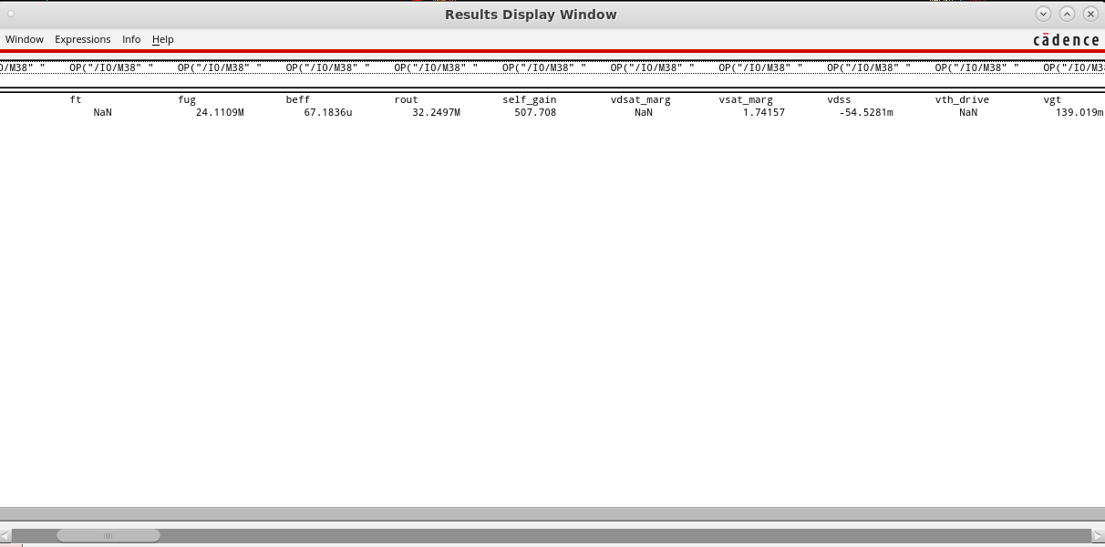

    I have run a dc simulation using MAESTRO and I understand that all parameters for M38 are not visible in the image I uploaded but if I scroll to the right I see them all. They appear horizontally hence I couldn't capture them all in the picture. But for M50 I see only 7 parameters as can be seen in the picture.
    I am attaching 7 images in which I can see all parameters for M38 after the dc simulation, however, I see only 7 parameters for M50. My question is why can I see all parameters for one MOSFET and not for all?

    First thing to check is whether M50 and M38 are the same type of transistor. It's possible that one of them is modelled as a subckt model, and the CDF may have only been set up to expose a limited set of operating point parameters - whereas if the other device is directly modelled it may expose all of the operating point parameters. So what devices are M50 and M38, and which PDK are you using?
    Also, how are you printing the operating point parameters? I'd expect the operating point parameters to be printed this way if you're doing a sweep in ADE (rather than a DC sweep in the simulator - which wouldn't affect the operating point results anyway).

    As you mentioned rightly, the MOSFET was modelled as a sub-circuit and going into it helped me get all parameters. Thanks!
