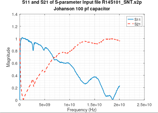

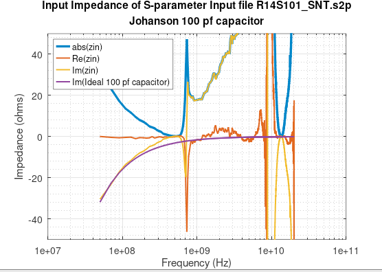

    ShawnLogan over 2 years ago in reply to Andrew Beckett
    Dear Maria98,
    Maria98 said:
    Can i simulate the structure to get ABCD parameters directly, or need to get ABCD parameters from the SNP file?
    Figure 1
    Figure 2
    https://community.cadence.com/cfs-file/__key/communityserver-discussions-components-files/38/abcd_5F00_example_5F00_octave_5F00_sml_5F00_121223.zip
