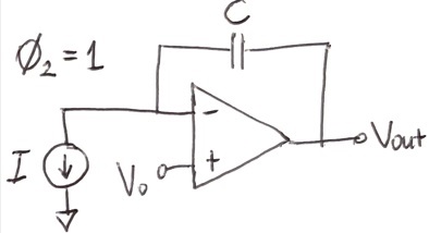

I am designing a ramp generator circuit that operates in two phases, controlled by non-overlapping clock signals ϕ1 and ϕ2. Below is a schematic representation of the circuit:
Behaviour:
  • When ϕ1 = 1, a switch shorts the feedback capacitor, and the opamp operates as a unity-gain buffer.
  • When ϕ2 = 1, the switch controlled by ϕ1 is open, and the only feedback element is the capacitor. A constant current source is connected to the inverting input of the opamp, generating a linearly increasing ramp at the output.

The equivalent circuit for the ϕ2 = 1 phase is shown below:
What is the recommended methodology to perform a stability analysis in such situations?

    Usually you would use pss (to simulate a period of operation of your clocks) and then pstb to give you the time-averaged loop gain of the amplifier, from which you can assess the stability. Then you are not dependent upon the instantaneous DC operating point, but a time-varying operating point.

    the circuit is an integrator. If input is not periodic but e.g. fix, a non-periodic output will be present, but still stability can be checked. Run Transient, and use actimes
    & acnames (=stb) feature (best for different phases). This will check the stability of the integrator alone, so you get e.g. the phase margin for the op-amp.
    If the system is more complex like forming an SC filter, go for pss+pstb analyses.
