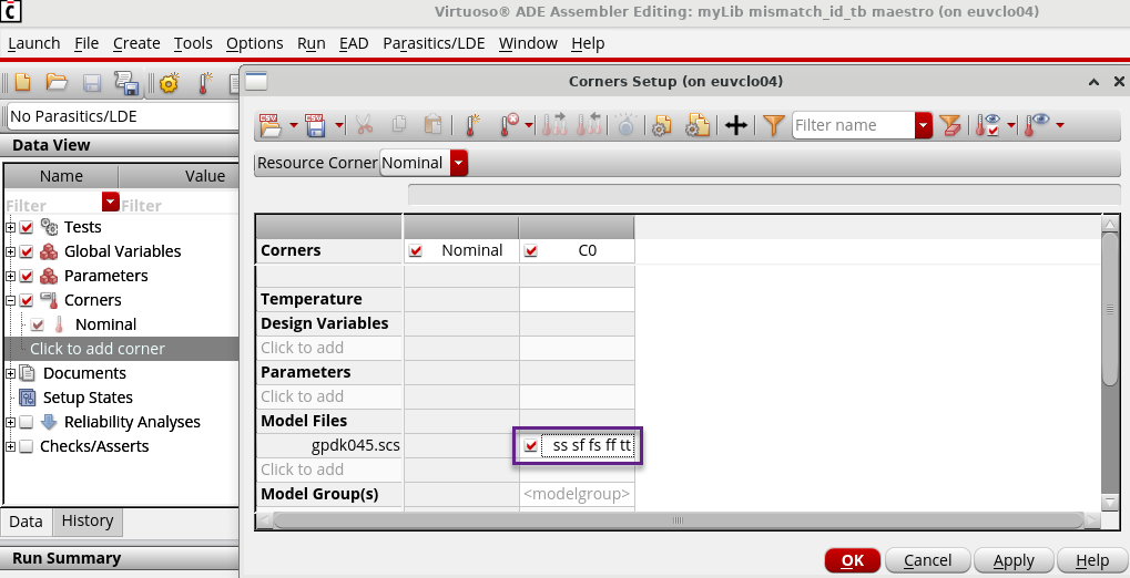

Hi, I'm trying to optimize my circuit to pass certain bandwidth and gain specifications under all corners tt, ss, ff, sf, and fs. I was wondering if there is a way to simulate all 5 of these at one time to see if any one design passes my tests for each corner.
Thank you!

    All you need to do is set up the Corners under ADE Explorer or Assembler. You can add one corner and configure like the following:
    This will create the 5 process corners you are looking for at once (once you create you will just need to expand to see them).
    I hope this helps.
    Alonso
