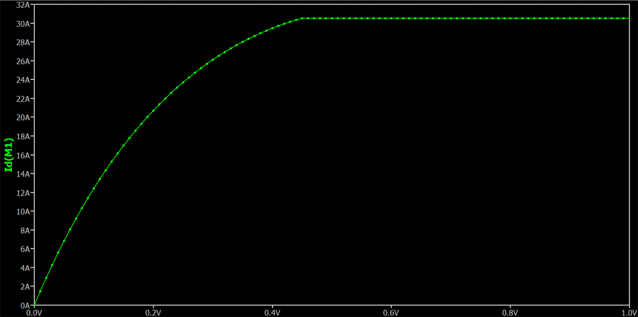

  • milind123
    milind123 over 1 year ago in reply to milind123
    Some more information. I reduced the model to just the MOS model:
    simulator lang=spice
    .SUBCKT MYMOS D G S
    * Internal MOS
    M1 D G S S MINT
    .MODEL MINT NMOS Vto= 4.100 Kp= 167.8 Nfs= 1.062T Eta= 0.000
    + Level= 3 Gamma= 0.000 Phi= 600.0m Is= 1.000E-24 UO= 600.0
    + Js= 0.000 Pb= 800.0m Cj= 0.000 Cjsw= 0.000 Cgso= 0.000 Cgdo= 0.000 Cgbo= 0.000
    + Tox= 100.0n Xj= 0.000
    + Vmax= 403.3
    .ENDS
    I just used this model to do a DC Vds sweep (VGS=5V) in Spectre and compare it to a Spice simulator.
    The Spice simulation output looks like this:
    while the Spectre simulation looks like this:
    So something is not right in just the model simulation for level 3 mos model in Spectre. I don't know what am I doing wrong. Any guidance will be helpful.
    Thanks.
    Andrew Beckett over 1 year ago in reply to milind123
    For a start, there is no W and L specified on the MOS instance line, so I'm assuming some default values must be being used. With Spectre, these are 3um for both W and L, and my guess is that it must be larger (especially if the currents are that high). I don't know which SPICE simulator you are comparing against.
    That said, just increasing the W and L to something much larger doesn't match (I set them to 1 each as I found some reference that this might be happening with LTSPICE, but elsewhere it said 100u was the default). With 1 I needed to set wmax and lmax in the model to a bit higher to prevent a warning. This is all guesswork though since I don't know what you're trying to be compatible with and if it's even feasible to be compatible.
    You might want to contact the model provider to see if they provide a Spectre-compatible model or at least one for PSPICE (we have pspice_include in Spectre which gives a good level of compatibility).
  • milind123
    milind123 over 1 year ago in reply to Andrew Beckett
    Thanks for this information. I simulated it in Qspice. I am trying to dig what are the default W/L this would use. So this is something that is different even though we are importing a Spice model I did not know that the Spice defaults are not known by Spectre. So this is a good caution for me for the future.
    I am trying to see if I can get an alternate model or a Pspice model from somewhere and try that. If I create a Pspice cell view would that be equivalent to pspice_include?
