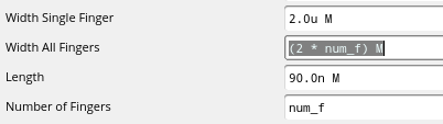

I need to compare transistors from different foundries and I'd like to do that by running several DC simulations where I sweep the number of fingers (keeping the other parameters fixed).
Ideally I'd like to do something like here below
but this does not work, it does not throw any error , but the results are wrong.
Any suggestion on how to do that ?
thanks
Tommaso
  • Volker T
    Volker T over 1 year ago
    presumably, you only need to use a valid number in your "Width All Fingers" field (usually, this should be computed automatically anyways from "Width" and "Number of Fingers").
    Anyways, your "Width All Fingers" results in a device width of "2 meters times num_f", which is a value the simulator will limit to maximum device width allowed by your PDK for the respective device, which is why you don't see the expected effect.
    Try (2.0u * num_f) instead.

    right, that's a good point. that worked, thanks!
