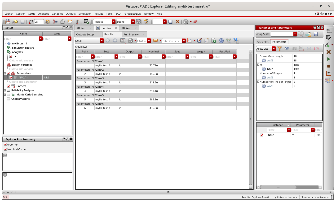

So how can I do a Design Variables sweep for the multiplier or finger value for mosfet (n1lvt) cds_ff_mpt ?
    Andrew Beckett over 1 year ago +1
    Don't do this via a design variable sweep. Instead, use the Parameters section in ADE Explorer. If you use the click to add parameter, you can then easily select the instance on the schematic, choose the…
    Andrew Beckett over 1 year ago in reply to hesaliveJim +1
    Glad it worked! For completeness, here's the image I was trying to post:
    Don't do this via a design variable sweep. Instead, use the Parameters section in ADE Explorer. If you use the click to add parameter, you can then easily select the instance on the schematic, choose the parameter to sweep and then sweep it. You can use matched parameters if you need parameters to track, plus you also have the group as parametric set available for parameters too. I was trying to upload a screenshot but unfortunately it's broken again for me and my usual backdoor has broken too.

    Andrew thank you, that works quite nicely including group as parametric set.
