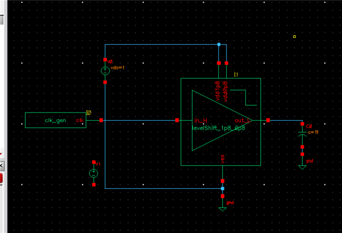

I am trying to run very basic circuits via the Virtuoso AMS simulator by invocation of the Xcelium toolchain through an ADE Explorer maestro view.  My topcell consists of a basic Verilog clock generator module feeding into a CMOS level shifter:
I have created a configuration for this via HED using the AMS template, and use this configuration as the "design" in the ADE Explorer test.  Connect rules are set to a default "full fast" setting using 1V nominal, which is well within the capabilities of the CMOS.
When I Netlist and Run, the simulator window pops up with the following output:

It appears that during some part of elaboration (xmelab?), the process fails to cache the library "spi_master_trx_verilog" and the "axstepko_spi" library, which contains the cell I wish to simulate and in general needs to be used in design.  I have had success running AMS simulations from other Cadence tutorials and saw the simulator caching all of the required libraries, and so I suspect that something to do with library paths is the problem here.  The "spi_master_trx_verilog" is attached to the master library via an INCLUDE statement in the root cds.lib:
INCLUDE <sanitized>/Cadence_22nm/SPI-Master-TRX-Verilog/cds.lib
Inside of the referenced cds.lib:
DEFINE spi_master_trx_verilog <sanitized>Cadence_22nm/SPI-Master-TRX-Verilog/spi_master_trx_verilog
Any suggestions on what I should try and check are greatly appreciated, this has been very confusing to debug thus far!

    Andrew Beckett over 1 year ago in reply to AS202502163432
    Your best bet would be to contact customer support - log into http://ask.cadence.com and then use the Case menu to submit a case.
    It looks as if the blocks in question may not have been netlisted and hence not compiled (I think this "Caching" is a red herring). Your log (which you've sanitised) doesn't appear to show any modules having been compiled from the netlist.vams so maybe the schematics from this spi_master library weren't netlisted. It's really hard to tell without more info about how these are instantiated, what's in the netlist, any messages produced and so on. A support case would make this much easier than trying to communicate via a public forum (which is not a substitute for regular customer support).

    When I examine the netlist.vams file it is empty aside from including disciplines and userDisciplines. This is not the case when netlisting inside of the Virtuoso ADE Explorer interface itself.
    How can I, in general, compile/netlist a library/cell?

    This is what is inside of the empty netlist.vams:
    // AMS netlist generated by the AMS Unified netlister
    // IC subversion:  IC23.1-64b.ISR11.29
    // Xcelium version: 24.09-s013
    // Copyright(C) 2005-2009, Cadence Design Systems, Inc
    // User: as5352 Pid: 2723230
    // Design library name: spi_master_trx_verilog
    // Design cell name: clk_gen_tb
    // Design view name: auto_config
    // Solver: Spectre
    `include "disciplines.vams"
    `include "userDisciplines.vams"
    // HDL file - spi_master_trx_verilog, clk_gen_spi_test, verilogams.
    The clk_gen_spi_test was copied from another library where I am in-fact able to successfully simulate out of, and whose netlist.vams is populated with much more "useful" information about module connectivity, etc..  For whatever reason, this spi_master_trx_verilog library has this problem of generating an empty netlist.
    The library spi_master_trx_verilog does reside within a Git repository, but I have been able to run Spectre out of this library with no problem.

    It would appear that the netlist generated by ADE Explorer (through the manual Simulation -> Netlist -> Create option)  is not the same file as the one generated through a "Netlist and Run" which invokes the xrun command similar to the one in my original post.  The one available when clicking on the "netlist.vams" in the xrun log is empty.
