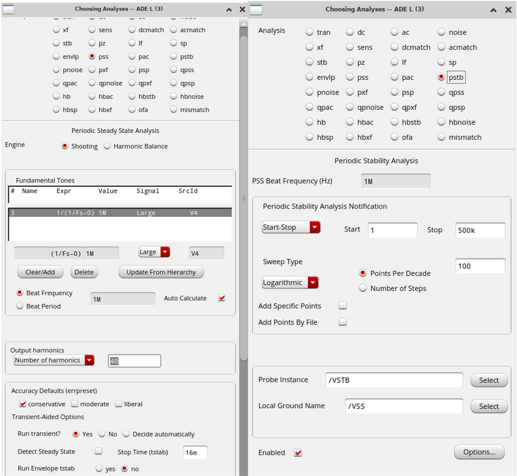

I am new to power converters. I am currently working on a controller design for buck. I wanted to simulate the stability response for the circuit. While pss is working as per expectation, pstb is giving '0' (-6.4kdB) loop gain and phase. I am using voltage source as probe at the o/p to break the circuit. Can anyone help me - what i am missing here?

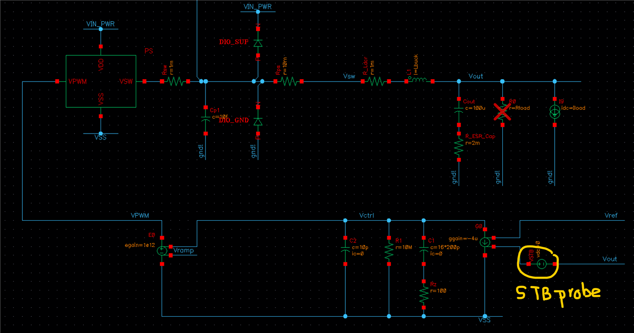

    If you don't show us your schematic, this will be very difficult. You have to put the probe at a node of the loop that is not being switched, because pstb examines sideband 0.

    Please see below:
    PSS and PSTB settings:

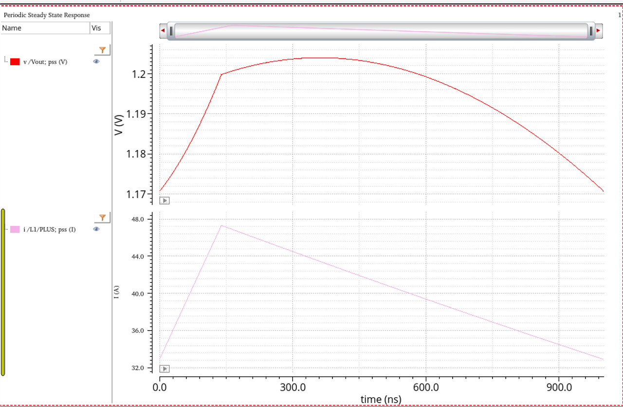

    PSS results:

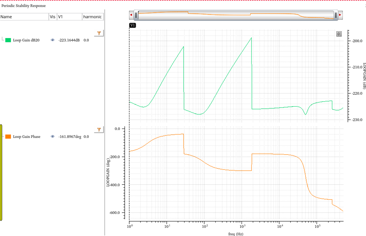

    PSTB results:
    When I res-simulated the loop gain magnitude is not exactly zero but very low!!
  • nrk1
    nrk1 over 1 year ago in reply to TH202510293247
    What is inside the block on the top left? Also, you have gnd! and VSS. I guess they are connected elsewhere. (I use iprobe or diffstbprobe as probes for stb/pstb-though the voltage source also works-another thing to try).

  • TH202510293247
    TH202510293247 over 1 year ago in reply to nrk1
    The top left is a model of power stage (switches from analog lib).
    Yes VSS and gnd! are shorted with a vdc in the testbench.
    Tried using iprobe, however, the pstb results didn't change.
  • nrk1
    Strange. I  guess you could try other locations (between the CCVS and the loop filter or the loop filter and the VCVS) for the probe and see if the results change.
