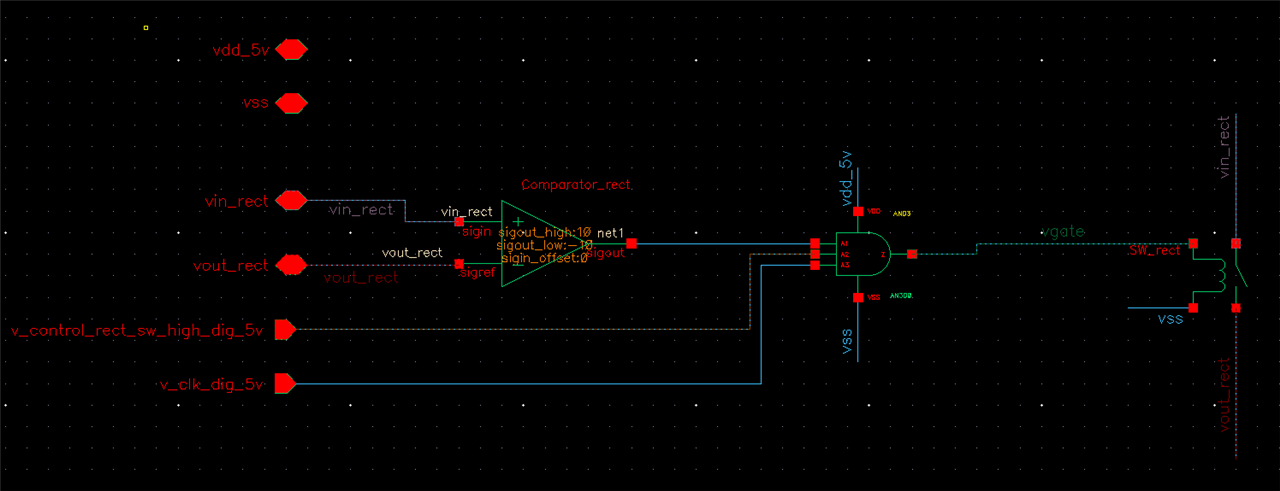

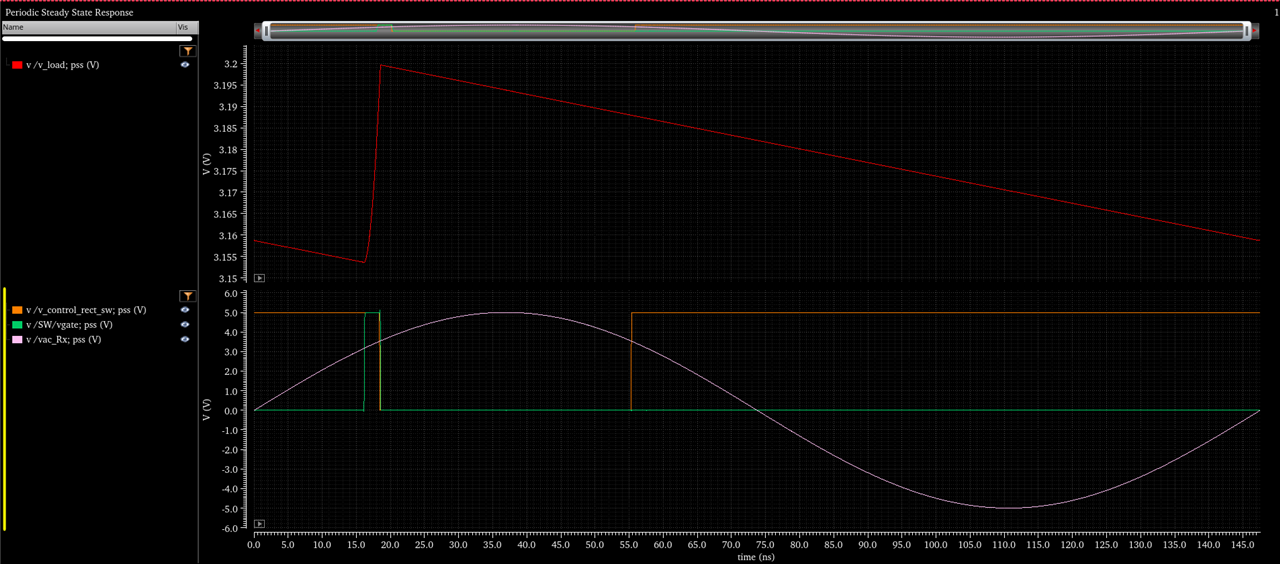

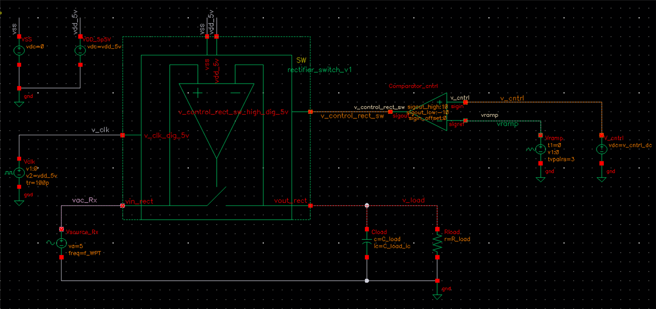

I have designed a simple rectifier with a switch (switch from analogLib) that turns on when the output voltage (v_load) intersects the AC signal and and turns off when the signal from PWM generator (implemented as a vcvs comparator, comparing a ramp signal and a dc signal - v_cntrl) is low. PSS gives steady state waveforms as expected. However, PAC gives 0V at v_load. For PAC the source V_cntrl has its PAC magnitude set as 1.
Circuit schematic
Switch schematic
PSS time waveforms

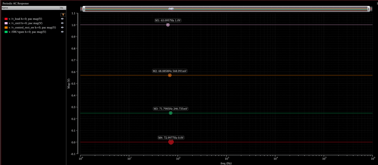

    The voltages obtained at various nodes in the circuit after PAC are below
  • Frank Wiedmann
    Frank Wiedmann over 1 year ago in reply to SA202512302438
    I suggest that you take a look at https://designers-guide.org/forum/YaBB.pl?num=1189658426 and check if (too) ideal components in your circuit are causing this effect. Please also note Ken's remark at https://designers-guide.org/forum/YaBB.pl?num=1107716368/53#53 : "To get PAC to work on a behavioral comparator model you need a transition region where the gain is finite, and the PSS analysis must put some points down in that region." Of course, this also applies to PSTB and PXF.
