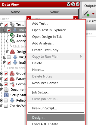

Hi all,
IC23.1 ISR16 / ISR15.
when making a copy of a maestro view and then in the new maestro view I change the design schematic (see below) , I loose all the ADE outputs and the analysis. Is there any fix to this bug ? it was not happening in the IC618
thanks

    RP202511066849 10 months ago in reply to TommasoF
    How do you copy the maestro state (or whole test-bench)?
    We used to have the same problem. If using the right-click-copy to create a copy this problem showed up.
    If you copy it via the copy wizard it works fine - at least it always does for my colleagues and me - . There's also no need to 'change design'  as it points to the correct one out of the box.
  • TommasoF
    TommasoF 10 months ago in reply to RP202511066849
    thanks, that works!
    Andrew Beckett 10 months ago in reply to TommasoF
    The important aspect of how you copy (from the library manager) is that you should use the "update instances" checkbox on the copy, and copy both the design(s) and the maestro view at the same time. Then all the references can be updated to point at the new copy rather than the original data.

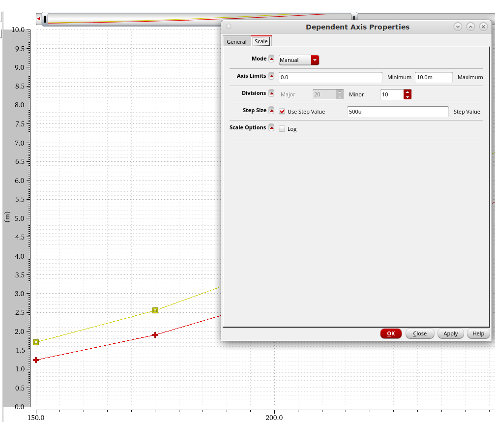

  • TommasoF
    TommasoF 10 months ago in reply to Andrew Beckett
    to get the scaling between 0 and 10mA  with the desired step size in this plot it took me a while, by default when entering the numbering and clicking apply it was reverting back to the original range. I did plenty of times in IC618 and never seen this.
    Thanks
