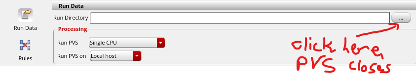

We are working with IC618.500.29 and have PVS installed and loads fine from Layout Suite.
However, whenever hitting 'browse for file' button, PVS window closes with no error in the CIW. This happens regardless of the file we try to browse for, or the PVS tool invoked.
This doesn't happen with either Quantus or Calibre tools.
Looking at pvsUI_ipvs.log, we get the following error:
'(pvsgui:3417506): Gtk-WARNING **: 15:17:57.522: Could not load a pixbuf from icon theme.
This may indicate that pixbuf loaders or the mime database could not be found.
Gtk:ERROR:gtkiconhelper.c:494:ensure_surface_for_gicon: assertion failed (error == NULL): Failed to load /usr/share/icons/Adwaita/16x16/status/image-missing.png: Fatal error reading PNG image file: bad parameters to zlib (gdk-pixbuf-error-quark, 0)'
I suspect it's either a permission issue, or a path setup issue, but all the recommendations online from linux forums didn't help so far.
Any assistance will be highly appreciated.

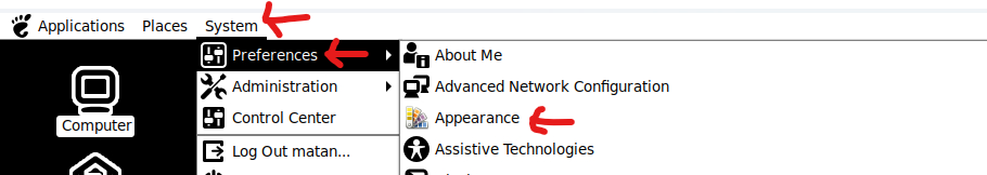

    In my case, our system admin defined our VNC viewers to run 'mint' desktop for whatever reason so I also had to:
    1. Install 'menta theme' from here:
    dnf install mate-themes
    2. Define 'high contrast' on 'system preference'->'Appearance':
    Then PVS browse files open fine...
    I'm just a bit baffled why PVS will have issues with anything but the 'high contrast' font...
