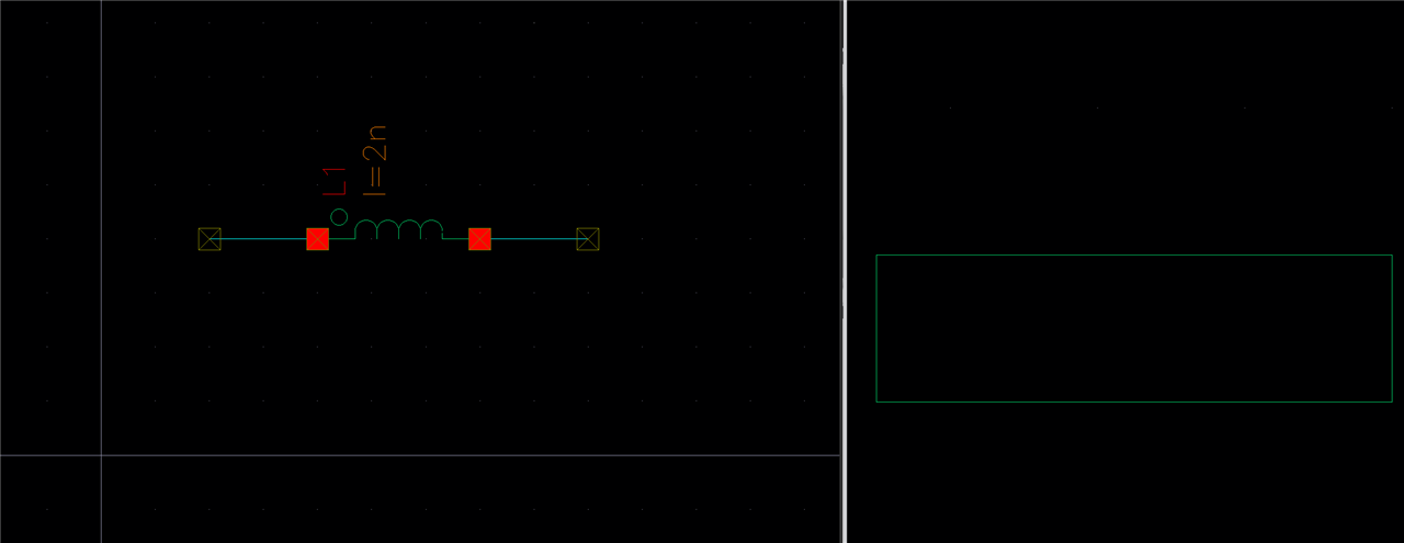

SKILL script to automatically generate a schematic and symbol for a 2nH inductor. The script executes without errors, but the ports are not appearing in the generated views (see attached image).
I'm using IC23.1. Could anyone help please

    Andrew Beckett 10 months ago
    To create symbol pins you need to use schCreateSymbolPin rather than schCreatePin. Something like this:
    ; Add pins to symbol
    ;schCreatePin(cvSym dbCreateNet(cvSym "in") "in" "inputOutput" nil 0.25:0.5 "R0")
    ;schCreatePin(cvSym dbCreateNet(cvSym "out") "out" "inputOutput" nil 1.125:0.5 "R0")
    ; Use the correct functions and also move the locations to be on the rectangle created above
    pinMaster=dbOpenCellViewByType("basic" "sympin" "symbolNN")
    schCreateSymbolPin(cvSym pinMaster "in" "inputOutput" 0.0625:0.18750 "R0")
    schCreateSymbolPin(cvSym pinMaster "out" "inputOutput" 0.5:0.18750 "R0")
    dbClose(pinMaster)
