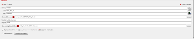

Hi everyone,
I'm trying to run LVS check using PVS. I'd like to include an external netlist and don't seem to do it correctly.
The PVS version is :
Cadence PVS version 22.2 ISR2
The schematic is a simple transmission gate, including 2 inverter cells.
I have the netlist of the inverter and would like to attach it for the LVS check.
Here is a schreenshot of the schematic:
In the PVS LVS Run Submission Form, in "Input" section, I select DFII option for the schematic.
To attach the inverter netlist, I selecte "Use Existing Include File". Here is a screenshot:
The include file looks as follows (real path ommitted here):
.include_spice "…file_path/inverter.spi"
Results show that the inverters are note recognized.
Any support on this would be highly appreciated.
Thanks!
  • pchris
    pchris 10 months ago
    Your inverter cells, do they have a schematic?
    The 'view list' I see in your screen shot is 'auCdl schematic'. From your description you want netlisting not to descend into your schematic so one option could be to copy the inverter symbol view to a view named 'auCdl'. Netlisting would then not descend into the schematic view and the definition for the inverter would be the one from the include file you are specifying.
    If this is not the issue or your inverter cell is in a read only library this may not be an option. Should this be the case please include details of the LVS error you are seeing.
    Thanks,
    Chris

  • pchris
    pchris 9 months ago in reply to GBlasco
    Hi Guillermo,
    Thank you for the additional details.
    On the PVS LVS run submission GUI, Input section there is a cyclic field for controlling how the netlist is created or if an existing netlist is used. By default it is set to ‘Create CDL’, there is also the option ‘auCDL’. This invokes the ‘PVS Internal Netlister’ which has slightly different behaviour. This is detailed in the PVS User Guide in the section Running LVS -> ‘Difference Between Standard CDL Netlister and PVS Internal Netlister’. Of note is this section:
    ❑ With auCDL/auLVS modes, when the PVS netlister sees a symbol but does not find
    a schematic or a stopping cellview, it adds the following information to the netlist and
    continues to process the rest of the schematic hierarchy.
    .subckt <Name> <pins>
    *PVSCELL netlisted from <name> symbol
    *.generic no
    .ends <Name>
    You can then include a CDL file that contains the description for all the leaf cells that
    did not have stopping views. PVS comparison will read the CDL description from
    the include file.
    I tried this with a schematic like the one you included above and using a modified version on an INV cell from one or our generic std cell libs. All worked fine, please try and let us know how you get on.
    Best regards,
         Chris
