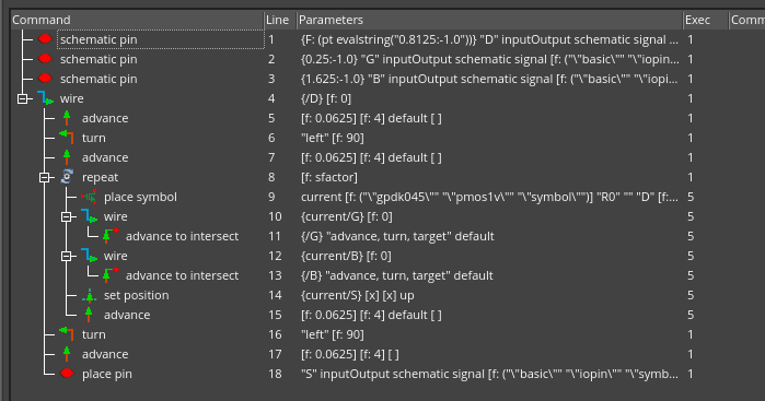

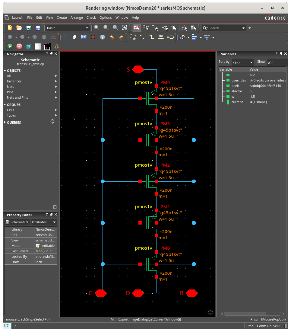

    Two approaches (both using transistors from gpdk045 as an example):
    PCell Designer
    In PCell Designer, the structure of the PCell would be as follows:
    Here's what an instance looks like with sfactor set to 5:
    This example can be imported into PCell Designer (note, you need the PCD100 license for this) using this file (it's a gzipped tar file containing the pcd.txt to import):
    https://community.cadence.com/cfs-file/__key/communityserver-discussions-components-files/38/seriesMOS.tar.gz

    RM202605273230 5 months ago in reply to Andrew Beckett
    while placing the pcell with sfactor 5 it will show 5 transistors or only 1 ?
    i am looking to use 1 transisotor symbol but have stacked inside it with sfactor 5
    Andrew Beckett 5 months ago in reply to RM202605273230
    In both cases you'd have a symbol as normal - that would show the single transistor. The approaches described above create a schematic PCell alongside the symbol - so if you descended (readonly) into the instance, the resulting schematic would show as many series-connected transistors as sfactor/ns whatever the parameter is called.
