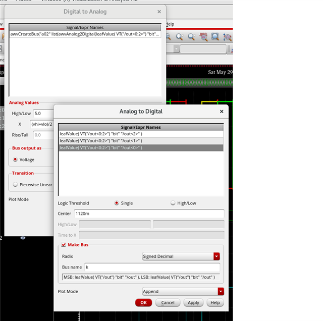

When ı plot to calculator, I get error as below. I want to convert binary signal to decimal.Please can help me.
ERROR (VIVA-3002):expression evaluation failed: val is not legal.
ERROR (VIVA-3002):expression evaluation failed: numConv(VT("/out<0:2>") "dec" t)

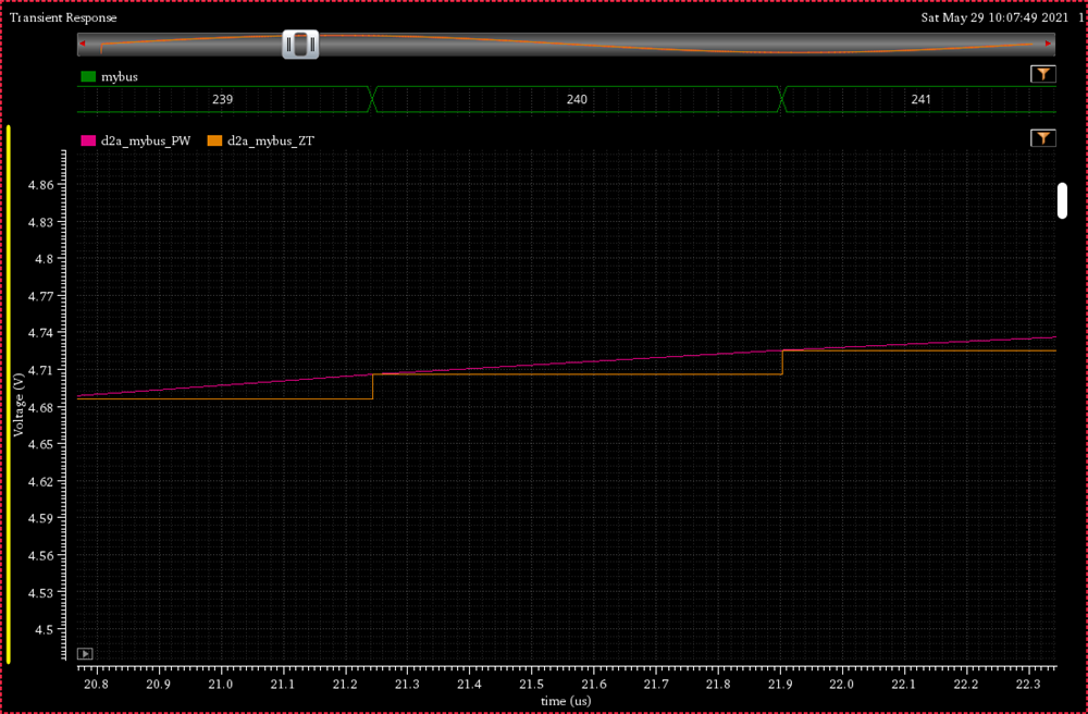

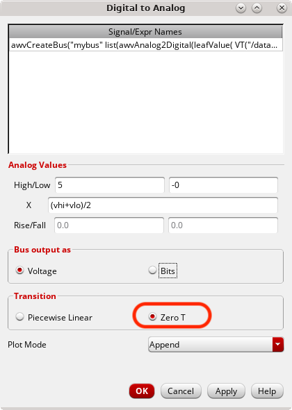

    It's not an error, it's a warning. However, given that the signal you're trying to do the PSD/FFT on is highly discretised (it's only a 3-bit bus after all), it probably makes sense to use the "Zero T" transition choice on the Digital to Analog form rather than "Piecewise Linear":
    You'll see the difference in the transitions as follows in the results (I've shown the output of the bus converted both ways):
    (the red is the piecewise linear, the orange is Zero-T).
    You will probably still get the warnings, but at least you know that there would be no interpolation. If the red curve had been used, then the sample points would have been between the discrete bus transitions and that's probably not what you wanted (I don't really know what you're trying to do with the PSD, but I doubt you'd want interpolated values to be used in the PSD/FFT).

    Yes, as I said, this will not remove the warning, but it will stop it interpolating which is what the message is primarily alerting you to. In general, if the input waveform does not contain regularly spaced time points (and those time points coincide with the sample points for the PSD/FFT) then there will need to be interpolation to re-sample at the points needed for the PSD/FFT. This warning is a fairly generic warning that gets triggered when it's clear there is sampling/interpolation needed (there are conditional parts of the warning depending on what has to happen). With an analog waveform you can do things like use strobeperiod in the transient analysis to only have an output at a regular timestep which improves accuracy and removes the need to interpolate. In your case however, this wouldn't help - the irregular x points are coming from the fact that the bus only has a time point when the bus value changes, and hence the bus converted to analog is similar.
    As I said, if you've used Zero T, you can ignore the warning - you are sampling at discrete values and so it doesn't really matter that the time steps are not regular.
