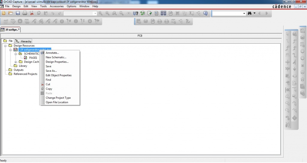

 Have you any idea, where is this "part manager" option from my OrCad 16.3?
 http://www.youtube.com/watch?v=AZRVEKfXfIc
Here is my screenshot:
 http://www.hobbielektronika.hu/forum/getfile.php?id=184650
 Thanks!

    You are running OrCAD Capture, you need to run OrCAD Capture CIS to get the Part Manager functionality.

  • cimo
    cimo over 13 years ago
    I am running OrCad Capture CIS icon but the the simple OrCad Caprure opening.
    What can I do?
  • oldmouldy
    oldmouldy over 13 years ago
    Do you have a Capture CIS license? Otherwise you will only be able to run Capture. If you do have a Capture CIS license, start Capture and try File>Change Product and see if you can select a Capture CIS product.
    If you have a Capture CIS license and the Change Product does not work, close Capture and run regedit.exe, locate the following key and delete it and all it's sub-keys: HKEY_CURRENT_USER\Software\OrCAD\CaptureWorkspace and restart Capture with the CIS license.
  • cimo
    Oh yes, thanks for your help! :D
     I changed the product in File>Change Product and see a wonder, it has already work :D
