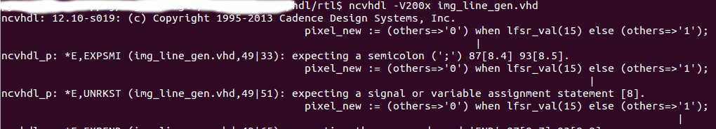

When compiling VHDL source with option -V200X, I get error on this line:
pixel_new := (others=>'0') when lfsr_val(15) else (others=>'1');
Any comments.
Thanks.

  • pyohayo
    pyohayo over 7 years ago in reply to StephenH
    Thanks. Here is screenshot of compilation results
    link to image

    Well, I had to guess at your data types, so this example might not be fully representative:
    library ieee;
    use ieee.std_logic_1164.all;
    entity dut is
    end entity;
    architecture rtl of dut is
    signal lfsr_val : std_logic_vector (15 downto 0);
    begin
    p : process
    variable pixel_new : std_logic_vector (7 downto 0);
    begin
    pixel_new := (others=>'0') when lfsr_val(15)='1' else (others=>'1');
    end process;
    end rtl;
    Even in Incisive 15.20 this produces the same error that you showed in your screenshot, however I can tell you that this compiles fine in Xcelium, so you should look to switch to that really.
  • pyohayo
    Thanks Stephen,
    Does it mean that my original guess was true ... i.e. ncim doesn't (at least fully) support VHDL2008 ?
    After all my version date 2013 ...
  • StephenH
    StephenH over 7 years ago in reply to pyohayo
    In general, language support is added incrementally, generally prioritised by customer demand. There is very little demand for VHDL at all, so most R&D effort goes into implementing SystemVerilog features (there have been 3 major SV revisions since 2008). In an ideal world we would have the time and money to implement every language feature for all languages, but in reality that isn't possible so R&D has to focus on the most needed features. In fact there are many aspects of VHDL and SV that are in the standard but in reality aren't useful so don't get requested or implemented!
