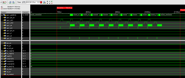

    Here it is:
    Perhaps with an example I can look and see what you mean by this:
    I mean I see clock (i.e.grp1_clk)  in SimVision, but don't see it in Virtuoso Graph window once simulation terminated.
    file_vcd.txt
  • pyohayo
    pyohayo over 7 years ago in reply to pyohayo
    Here is as it should look:
  • pyohayo
    And here are the same signals in Virtuoso:
  • pyohayo
    Resolved.
    In SimVision I've exported range 700us ... 1100us hoping that time will be shifted to 0 ... 400us, that wasn't the case.
