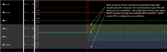

    Yes. I reviewed your code again, and it appears the issue may be with your implementation of the reset function. You define an internal signal d_en_rst
    as shown below:
    @(cross( V(RST) - V(AVDD)/2 , 1 )) d_en_rst=1; // Identifying RST level
    @(cross( V(RST) - V(AVDD)/2 , -1)) d_en_rst=0; // Identifying RST level
    However, your comment suggest the RST input is intended to be level sensitive but your definition is one where the signal d_en_rst will be set to 1 when your input RST crosses the threshold AVDD/2 with a rising edge (positive slope) and will be set to 0 only when the input RST crosses the threshold AVDD/2 with a falling edge (negative slope). However, I believe in the PFD implemtation the RST input needs to be a level sensitive - NOT an edge sensitive input. In your case, and with reference to your circuit diagram and figure in your latest post, I';ve annotated a version of the fiugre to detail the problem and included it as Figure 1.
    As an alternative to your implementation in your posted veriloga code, I might suggest you study the level sensitive reset DFF code provided by Ken Kundert at URL:
    https://designers-guide.org/verilog-ams/rf-models/dff/dff.va
    or simply include a pointer to his verilog in lieu of your implemention in your PFD (assuming you don't need the enable function to verify proper PFD operation.
    Otherwise, I think you need to correct your veriloga to make the RST input an asynchronous and level sensitive input and not an edge sensitive input. Let me know your thoughts Kulmani...I hope this provides some insight.
    Shawn

    Kulmani over 5 years ago in reply to ShawnLogan
    Hi Shawn,
    Thank you for your detailed response. I really appreciate this.
    Yes as you pointed out correctly, it is a level triggering issue.
    What i figured out is when my CLK goes high as it is edge triggered, the flag corresponding to that clock goes high and for the entire duration of Pulse Width High remains high, and when reset comes it tries to pull down my outputs but at the same time CLK flag being high pulls it up again in next time step so hence we were getting this oscillation kind of a situation.
    For the solution part what i have done is i am making my CLK flag low once the data has been assigned high value which in turn stops my output to rising again when RST goes high and keeps it in LOW state which is expected for RST condition.
    Here is  the modification that is working for me as of now :
    if (d_en_clk) begin
    q_int=d_high;
    d_en_clk=0;
    end
    With the above change my PFD outputs seems to be working fine.
