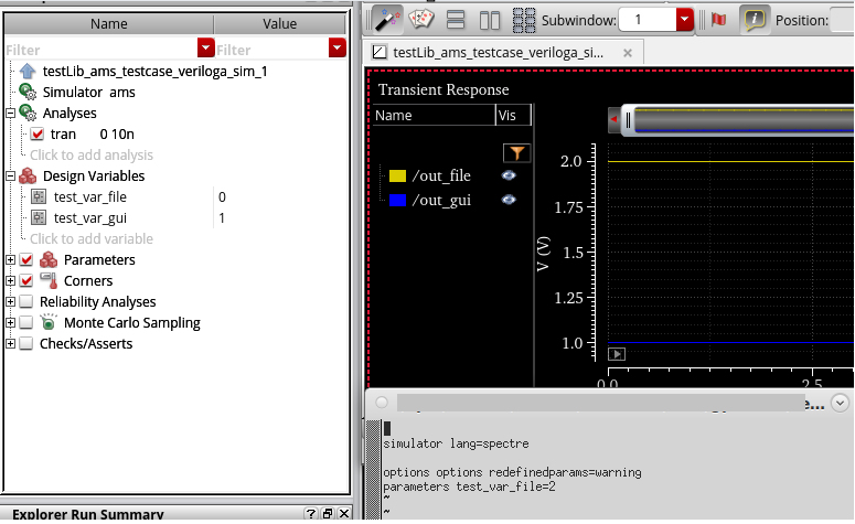

I am trying to include variables from an external file so that they are recognized and used in my simulation, along with the other variables defined in the Maestro view GUI.
If it were a fully continuous-time simulation using just one of Spectre engines (APS, X, ..., etc), I can easily do that by putting my variables in a file "my_vars.scs" and including them in my model libraries.
However, when I want to do something similar in an AMS environment (where a cds_globals.vams is auto-created and populated with variables from the maestro view), the variables in "my_vars.scs" are not recognized during the initial "netlisting" and thus cause an error.
How/Where can I include a file with those variables, so that they are recognized during netlisting?
Or is there a way to alter the way "cds_globals.vams" file is generated so that it could auto-include a file containing the variables -after the "cds_globals" module header- from the external file and pass them along with all other GUI-defined variables?
Things I tried:
I tried copying the generated "cds_globals.vams" file to be "cds_globals_mine.vams", and manually added an include statement to include "my_vars.vams" after the "cds_globals" module header. Then using an "hdl.var" file with
DEFINE XRUNOPTS /path_to_/cds_globals_mine.vams
It includes my variables but, the issue with that is that it doesn't update values if changes were made on the GUI anymore.

    It’ll help to see the exact netlisting error. If your design variable appears in Maestro view without a value (at the time of netlisting) and becomes the reason for netlisting error, you can choose to enter any dummy value for all such variables in Maestro view and let these be overridden by 'my_vars.scs' in Model Libraries.
    An example .scs file :
    simulator lang=spectre
    options options redefinedparams=warning
    // vdd was defined as 0 in Maestro
    parameters vdd=2

    I created a full, simplified testcase with the two scenarios. Both simulate a simple VerilogA module that just prints out the parameter values passed to it from the GUI at the initial_step transient event. It also outputs those as a voltage on its output nets.
    The two variables I am passing are "test_val_gui" and "test_val_file" for verilogA parameters "test_val_gui" and "test_val_file" respectively. The "gui" one is supposed to be passed from the mastro view while the "file" one is supposed to be included via a file.
    The verilog module testcase_veriloga is shown below
    Fullscreen veriloga.txt Download
    `include "constants.vams"
    `include "disciplines.vams"
    module testcase_veriloga(clk, out_gui, out_file);
    input clk;
    output out_gui, out_file;
    electrical clk, out_gui, out_file;
    parameter real test_var_gui = 0;
    parameter real test_var_file = 0;
    analog begin
    @(initial_step) begin
    $display("Testcase VerilogA %M: variable test_var_gui value passed is %f", test_var_gui);
    $display("Testcase VerilogA %M: variable test_var_file value passed is %f", test_var_file);
    end
    V(out_gui) <+ transition(test_var_gui, 0, 1p, 1p);
    V(out_file) <+ transition(test_var_file, 0, 1p, 1p);
    end
    endmodule
    The testbench itself contains an instance of this module and a clock source just to make sure the engine is running. It runs a transient sim.
    A. Spectre only scenario with my_vars.scs included in model libraries.
    1. Include the file "my_vars.scs" (below) in the model_libraries section.
    2. Set the spectre redefinedparams option to warning or ignore to avoid errors from variable "test_val_file" double definition (The one in the file and the unintended auto-imported one in the GUI)
    3. Running the simulation and ignoring the unset variable warning (ASSEMBLER-1610), as we already know the definition in the file sets that variable
    4. This case runs normally, and the variables are correctly passed to the VerilogA module as indicated by its output voltages and messages.

    B. AMS scenario with my_vars.scs included in model libraries.
    4. Deleting the empty "test_val_file" unset variable created before from the test "Design Variables" section. Not sure if this is necessary.
    5. This case gives a sim error and upon checking it shows
      xmelab: *E,CUVHNF (./netlist.vams,28|59): Hierarchical name component lookup failed at 'cds_globals.test_val_file'.
    Log, netlist and cds_globals below
    The log and netlist are seen below as testcase_ams_log and testcase_ams_netlist. The auto-generated cds_globals file is also shown as testcase_ams_cds_globals

  • Saloni Chhabra
    Saloni Chhabra over 1 year ago in reply to AA202510057331
    Instead of deleting the variable 'test_var_file' from ADE, you need to assign any dummy value to it e.g. 0. This value will be overwritten by my_vars.scs. Here's how my Maestro view and outputs look for your example. test_var_file is set to 2 through .scs file.
    Messages in xrun.log:
    Testcase VerilogA testcase_veriloga_sim.I0: variable test_var_gui value passed is 1.000000
    Testcase VerilogA testcase_veriloga_sim.I0: variable test_var_file value passed is 2.000000
  • AA202510057331
    AA202510057331 over 1 year ago in reply to Saloni Chhabra
    Hi Saloni,
    Thanks!
    I tried that and it is working.
    I got confused at the beginning by the fact that when I put a value in the GUI, the cds_globals took that value and passed it to the netlist. I didn't know that later, the actual value that is used in the sim is the one in the model libraries file.
    Thanks and best Regards,
    Ahmed
