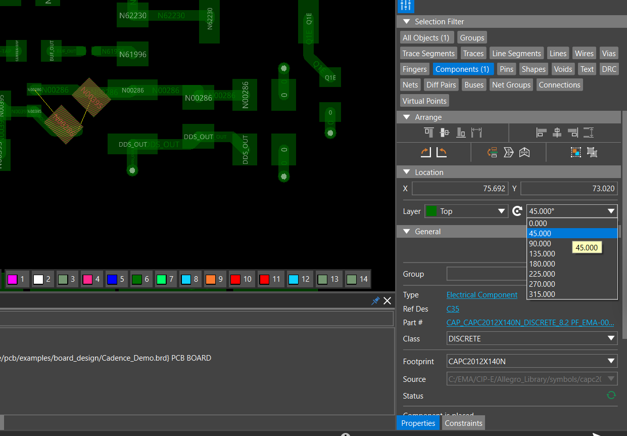

  • JuanCR
    JuanCR 7 months ago in reply to DG202504226528 +1 verified
    Hi DG202504226528 You can find the option in the Properties Panel under the "Location" section:

  • JuanCR
    +1 JuanCR 7 months ago in reply to DG202504226528
    Hi DG202504226528
