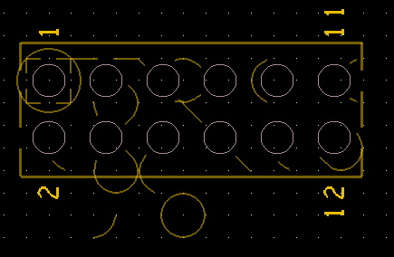

 Does anyone have some SKILL code that will clear silkscreen lines back x distance from pins, either as a group or individually?  I want to use this during footprint building.  Currently I have to use delete and cut to remove pieces of lines that run through pads.

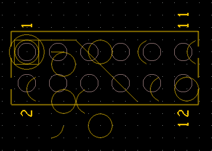

    My test symbol:
    Before:
    After:
