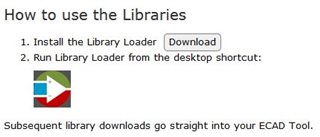

How can I import a footprint into OrCAD PCB Designer Professional?.
I download the file from any provider and run the .bat file
with the following problem appearing: Cannot open script file; No match found for 'footprint.scr' in the search path.

    All you need is a 'footprint'.psm file and the padstacks that as associated with it. Place that in your footprint library location and import it.
  • CadAce2K
    CadAce2K over 6 years ago
    Your .bat file is calling for a .scr (script) file. You need to have the script file also.

    I download the footprints from https://componentsearchengine.com/. Once downloaded I go to the Orcad_Allegro16 folder, where I have a .bat file, an edf file for the schematic and three .scr files.  I open the .bat file and I get an error. Try downloading a component from that page and see if you can enter the footprint. I am using version 17.4
  • CadAce2K
    CadAce2K over 6 years ago in reply to Bellido98
    Did you think to read the instructions? You need to download their Loader 1st.
  • Bellido98
    Bellido98 over 6 years ago in reply to CadAce2K
    I already have that program installed, but it does not automatically add the symbol and footprint of your component, or perhaps it is not doing something right.
    Could you try adding a component from the page that I told you with that program? It would be a great help if I could add the components of that page.
