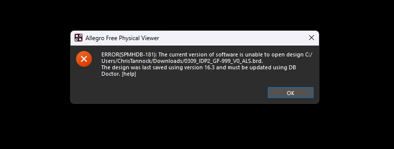

Any one know where to download or access DB Doctor?
Need to convert a .brd file from 16.6 version to 17 version....
Thanks,

    Hi JohnT, I use Orcad PCB Designer and I Think allegro_uprev utility is not licensed. But it's possible to use DBDoctro for complete directory. The path must be entered manually e.g. :\Cadence\Allegro…

    As per my previous message I will need to know the tool version: 17.4, 22.1, 23.1? I can then send you the appropriate program by mail once confirmed.

    i have the same error, but i don't have the pcb doctor in the cadence pcb utilities file

     Assuming you are using a windows installation, can you please try by going to the windows "run" app and enter "dbdoctor_ui".
      Hopefully this works. Please let me know what Allegro installation you have, as per the information on Help Menu > About.

    I couldnt  find  when I ran it and I have to upload my design can you help please??
    (SPMHDB-181): The current version of software is unable to open design ee101zener.
    The design was last saved using version 16.5 and must be updated using DB Doctor. [help]
