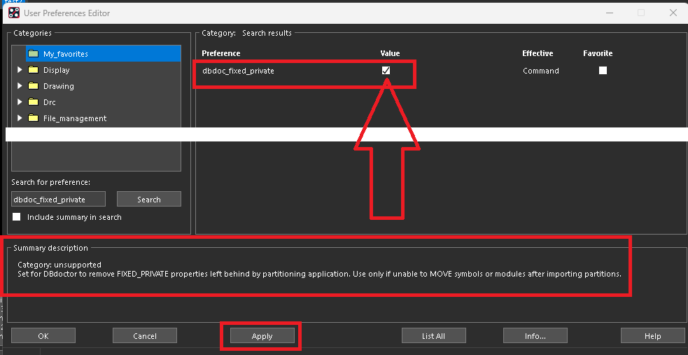

    Hi Zhifeng thanks for sending this.  I have managed to delete this room. It turns out to have been assigned a "fixed private" state. We will investigate this further in the tool.
    For now the fix is to check the user preference dbdoc_fixed_private .
    With this setting Dbdoctor will now remove the FIXED_PRIVATE properties left behind by partitioning.  Now run DBdoctor  by going to Tools > Database Check, select all options and Check the board.
    After doing this you should be able to delete this room directly. Let me know if this works!

    0 Zhifeng Jin over 1 year ago in reply to John T
    Thank you very much. Through the method you provided, I just tested and deleted it. I don't remember why this Rectangle appeared here at that time, but at least I can delete it now. That's great!Handshake

    I found that in OrCAD X PCB Presto 24.1 (OrCAD X Professional Plus), a blank PCB will generate a similar rectangle (0_QP) when importing a brand new netlist using the Update PCB function under ECO, which is somewhat similar to the current issue. By default, these rectangles have a 'locked' attribute and cannot be unlocked or deleted. I can only delete them using your method.
