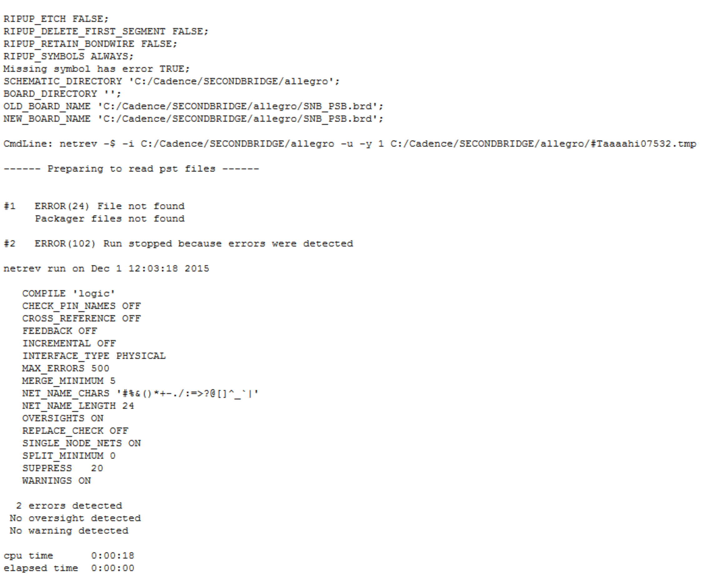

    I tried in this way but i am getting following type of errors
    #5 ERROR(SPMHNI-176): Device library error detected.
    ERROR(SPMHNI-189): Problems with the name of device 'CERAMIC_ANTENNA_0_WE7488930245_WE7488930245': 'Name is too long.'
    How to tackle this kind of errors.
    Anirudh

    0 steve over 10 years ago
    Setup - Design Parameters - Design tab and change the long name size from 31 to 255. You can set this by default from Setup - User Preferences - drawing and set the value there for allegro_long_name_size.

    I followed your procedure and i got following error.
    Can you please help in solving this above error.
    Anirudh
  • steve
    It's the same error as before - it can't find your Packager files - I recommend closing PCB Editor and creating / importing the netlist from inside Capture like the video shows you......
  • AnirudhTHABJUL
    0 AnirudhTHABJUL over 10 years ago
    Thanks a lot dude .....! :)
    I am able to do it.
