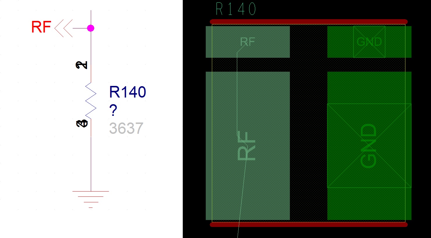

Capture will allow two pins to be on top of each other and will connect both pins in the netlist. Is it generally acceptable to do such a thing? Thisis for the following component: http://www.vishay.com/docs/30099/wsl3637.pdf
  • redwire
    redwire over 9 years ago
    Even though it works it's generally unacceptable practice.  Just move the pins to the next grid to the side (edit->symbol) and connect them back with a wire on the schematic.  You'll have the same netlist and a clean drawing.
  • aricbeaver
    aricbeaver over 9 years ago
    Ok, thanks for the reply. I did hide the pin numbers and it looks like a normal clean resistor. A single resistor with 4 pins coming off it looks odd IMO.
  • redwire
    So...it depends but a signal connection should normally be shown on a schematic.  The connection you are attempting is known as Kelvin connection.  By hiding the pins you are hiding how it is connected.  Generally unacceptable.
  • aricbeaver
    I agree it should be shown if it were intended to be a Kelvin connection; however the suggested footprint in the datasheet for that resistor I believe is intended to center the resistor for assembly purposes not for a Kelvin lead connection which has to be implemented at a board level unless an "etch" component is inserted into the schematic separately from the resistor.
  • Wild
    Wild over 9 years ago
    Data sheet states it is a current sense 4 terminal resistor.
    So the schematic symbol should be a single resistor with four pins.   If you use 2 resistors, there will be 2 resistors in your BOM.
    So the footprint should have 4 pins, also and be created as a single part.
    BTW this common practice for current sensing.
