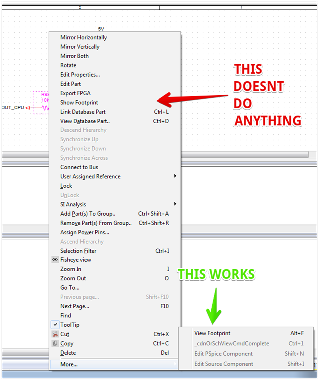

The footprint viewer functionality appears to be missing in OrCAD Capture 17.2.  Can anyone else confirm and/or suggest a fix?

    Hi mrigashira, I just tried to do this and the "Show Footprint" command doesn't do anything. I wonder if it is because I have the tcl script (mentioned above in this thread) installed, and maybe it's blocking the integrated feature? Any ideas?

    steve said:
    If you have used the tcl file above you need to rename the file capFootprintViewer.tcl to .old or move it away from the capAutoLoad directory, then restart Capture
    Yes, I believe you should try that as mentioned by steve. You might also want to doublecheck the INI file, first, it has to be the one in your %HOME% directory (example: C:\Users\jfuoco\cdssetup\OrCAD_Capture\17.2.0\Capture.ini) and second, the variables and values in the [Footprint Viewer Type] and [Allegro Footprints] sections are correct.

    Bingo, that fixed it. Weirdly when I was viewing this thread I hadn't seen the response from steve but upon renaming the file to .old all is well. Thanks guys!!
