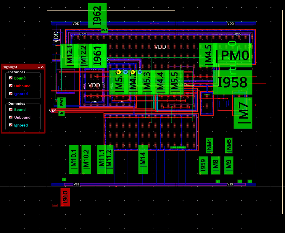

Binding highlights are shown simultaneously in both the layout and schematic canvases, providing consistent visibility across views.
In the layout canvas, instances and dummies are visually overlaid with colors based on their binding status.
Binding highlights in layout canvas

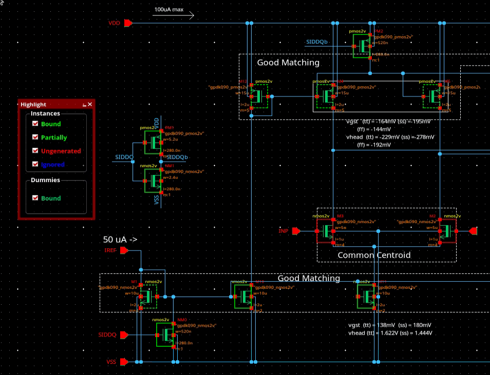

In the schematic canvas, devices are highlighted using colored bounding boxes, including clear identification of partially bound instances.
Binding highlights in schematic canvas
This parallel view helps correlate layout and schematic intent and reduces ambiguity when reviewing binding state. The binding color map added as a legend in both canvases provides continuous visual guidance. You can use the checkboxes in the color map to control whether binding states are shown or hidden.
