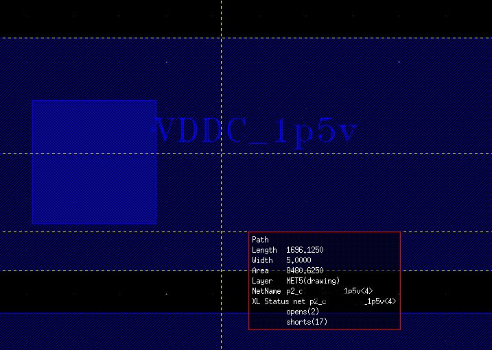

    This is still a problem even in 6.1.5.500.10, nothing helps, niether extract neither update comp&nets. Placing pin will not help also (pic).
    There is no lxStickyNet set.
    Why this can't be simple, if there is a pin placed anywhere in metal structure, all shapes/paths merged/added shoud get the same connectivity as pin. Even thru hierarchy, (eg some pcell with only metal shapes, no pins, no nets).
    I have ~10k wrongly assinged paths/vias, select "All shapes on net" doesn't work also.
    This is really annoying.
    BR
    Srdjan

    Andrew Beckett over 13 years ago
    Very hard to work out what your issue is from a picture - I suggest (as we usually suggest) that you log a service request
  • Alex Soyer
    Alex Soyer over 13 years ago
    Could you please check if your via is inside a route object or not ?
    Before running this command please select your via in the canvas
    css()~>route~>prop~>??
    ((db:0x3dbc3af6 cellView db:0x35d7519a objType "prop"
     prop nil enum nil name
     "lxStickyNet" object db:0x3db0a4e5 range nil
     value "TRUE" valueType "boolean" assocTextDisplays
     nil
    Virtuoso could store this lxStickyNet property on the route which is not editable trhough the Property Editor interface, it could only be removed by skill.

  • sPoK
    sPoK over 13 years ago
    Hi Alex,
    css()~>route~>prop~>?? gives me only one nil, this is a correct command, right? (via is selected)
    Thanks, Srdjan
  • Alex Soyer
    Hi Srdjan,
    Yes, you are correct this is the right command.
    If it returns 'nil' then your via is not part of a route then if it does not have the lxStickyNet property on it and the same property is not on the route object then this via should be re-assigned to teh correct connectivity when running the extractor.
    Please make sure to set the extraction hierarchy level if required.
    You can make some trials using the Layout XL Wire Editor and assigning the net connectivity using the F3 option form, it should return the lxStickyNet property on it.

  • Alex Soyer
    Could you please check what is the value of the following virtuoso environment variable:
    envGetVal("layout" "extractKeepShapeAssignment")
    It should return nil if you would like the extractor to re-assign pin connectivity.
    You could as well check in you .cdsenv:
    layout    extractKeepShapeAssignment        boolean  t
